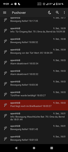

when using this pushover rule, it happens from time to time that the old state is send instead of the new
rule "Push"
Item Push received update
val pusholi = getActions("pushover", "pushover:pushover-account:oli")
if (Bitte_nicht_stoeren.state == OFF) {
pusholi.sendMessage(Push.state.toString.replace("ue","ü").replace("_"," ") + " " + new DateTimeType().format("%1$tk:%1$tM:%1$tS"), "openHAB")
i cant use “changed” because it should send even when the state is the same
example:
when the post arrives and after some time new post arrives and in the time between no new push has send
is there any chance to fix the bug i described?
i dont think you know what i mean
i cant use “changed” because i need to send every message which is executed by Push.sendCommand
even if it has the same content (“changed” will not send pushover if two times new post in mailbox arrives and between the two messages there was no new trigger with other content)
the bug is sometimes it sends old content when there was new content
i show you an example

Fine, I didn’t tell you to use trigger changed. I wanted you to be aware that you can get duplicate messages if you trigger on update, because two updates may have the same value.
You are complaining about duplicate messages, after all.
If you are updating your Item very fast, there is the possibility of the Item state changing from what is was at trigger time while the rule is in progress. That wouldn’t give you “old” values, it would miss some out instead and give you duplicate “new” messages.
You should be able to avoid that by using newState implicit variable.
Okeydoke, the important parts -
2021-12-09 18:01:43.029 [INFO ] [openhab.event.ItemStateChangedEvent ] - Item 'Push' changed from Bewegung Keller! to Die Post ist da! Batt: 3.09V
2021-12-09 18:03:55.005 [INFO ] [openhab.event.ItemStateChangedEvent ] - Item 'Push' changed from Alarm deaktiviert! to Briefkasten entleert Batt: 3.09V
Which should trigger your rule. Not shown here are any ‘updates-to-same’, which would also trigger your rule.
I can see a lot of Push messages, some of which may or may not have something to do with your rule.
I’d guess this is about Pushover, but let’s find out.
Add some logging so that you know when your rule is triggered and what it thinks it is trying to send.
rule "Push"
logInfo("mypushrule", "Rule starts with state " + Push.state.toString)
logInfo("mypushrule", "Rule ends with state " + Push.state.toString)
I note you are sending several messages per minute - does Pushover work okay with that? I’ve no idea.
