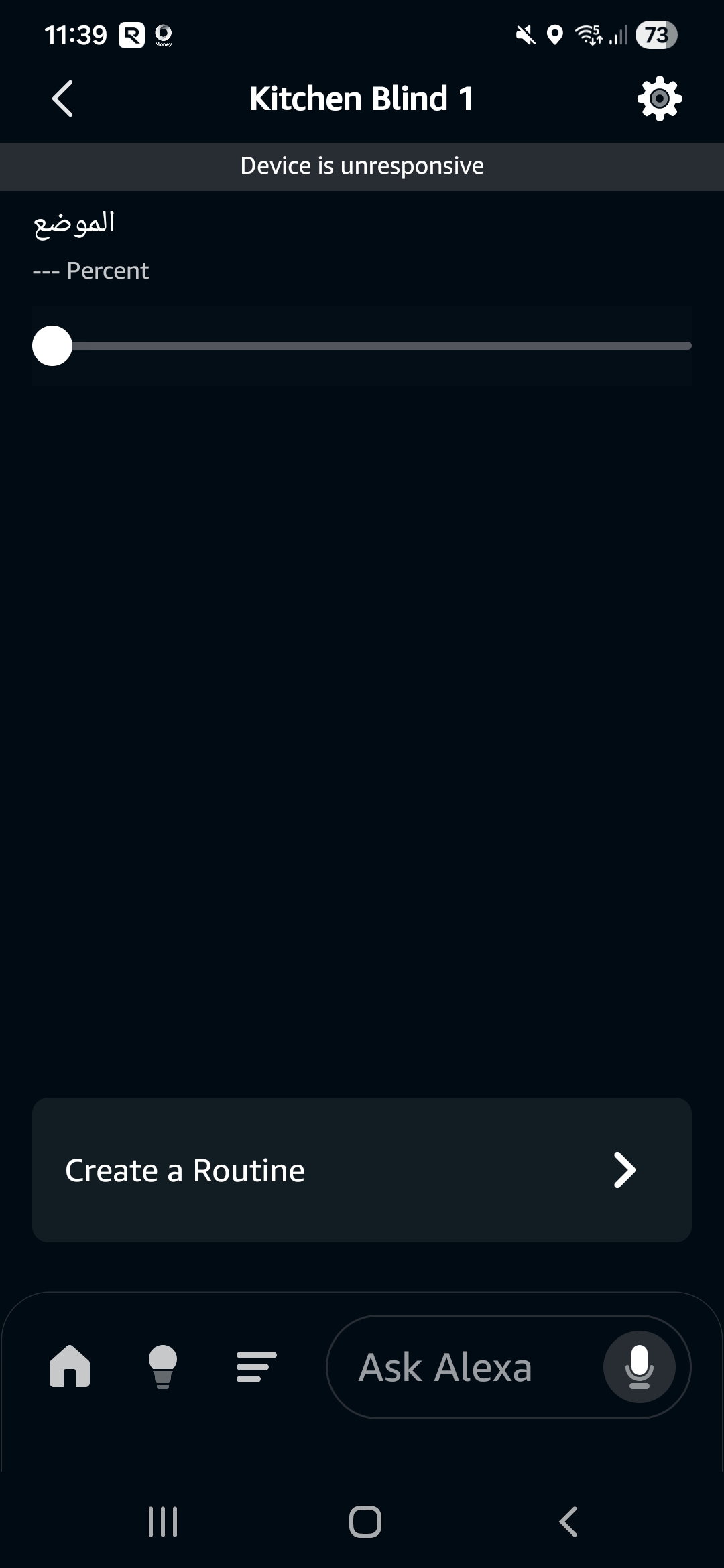

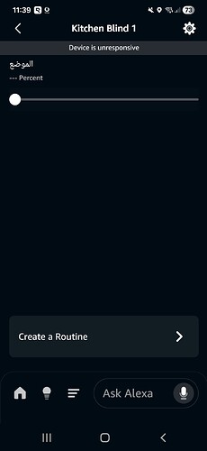

Have a bunch of Somfy blinds in OH 4.3.6 and have the Metadata of “Blind” set for Alexa Device Type. They’ve been working great since I initially set them up (2yrs+) but in the last few days they appear in the Alexa app really strangely (see attached, with Arabic-like text?). In addition, the Up, Down and Stop buttons have disappeared for the blinds. They still “work” via voice commands but not in the Alexa app itself. Anyone got any thoughts? Tried removing from the Alexa app and re-adding but they come back in the same as before
