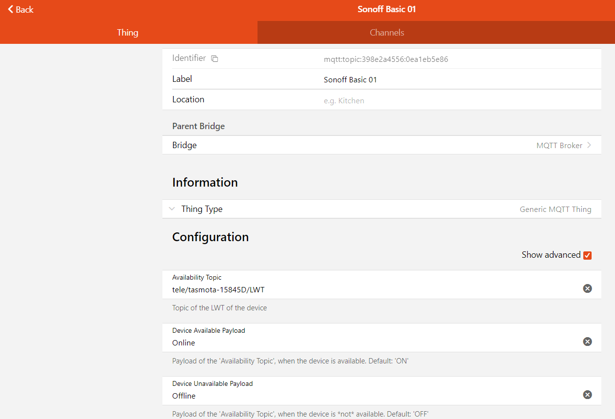

Device with issue:
UID: mqtt:topic:398e2a4556:0ea1eb5e86
label: Sonoff Basic 01 (flashed with tasmota 9.2.0)
stateTopic: stat/tasmota-15845D/POWER
Issue:
After power outage, when power comes back on, this sonoff tasmota turns on automatically. In the logs, openhab (v3) shows it as an itemstatechanged event. But there are no rules that trigger this device. I have other rules that trigger other devices, which work fine.
