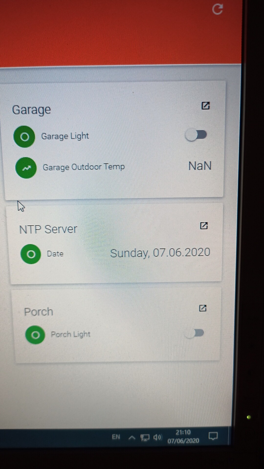

Having trouble setting up things so can read the temperature reading.
Please need some help.

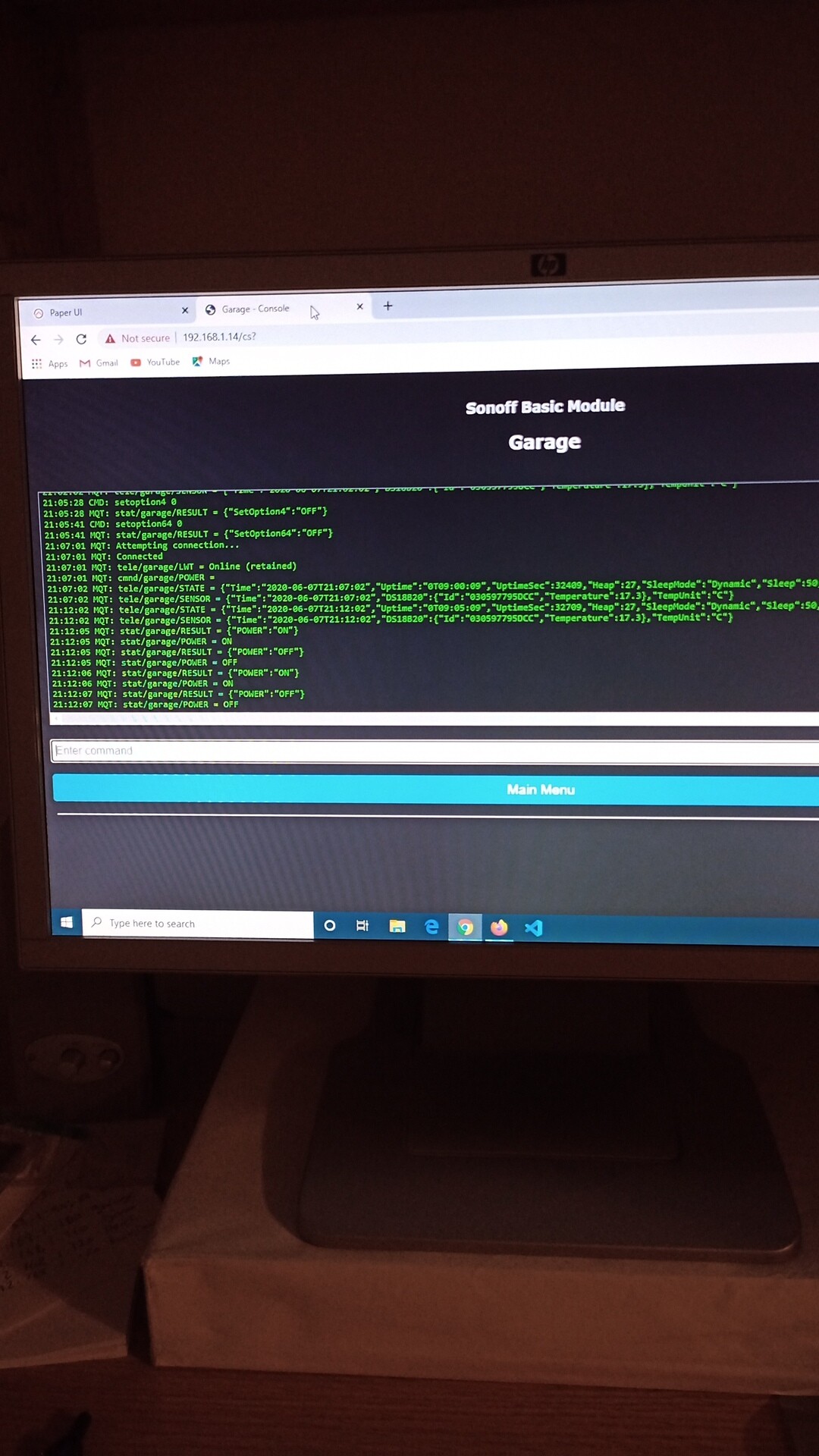

Check the tasmota console if and how the sensor readings are published.
Additionally you can use mqtt.fx or similar to check what is being published.
You didn’t tell us how and if you configured an item for the sensor reading
It’s publishing as tele/garage/sensor

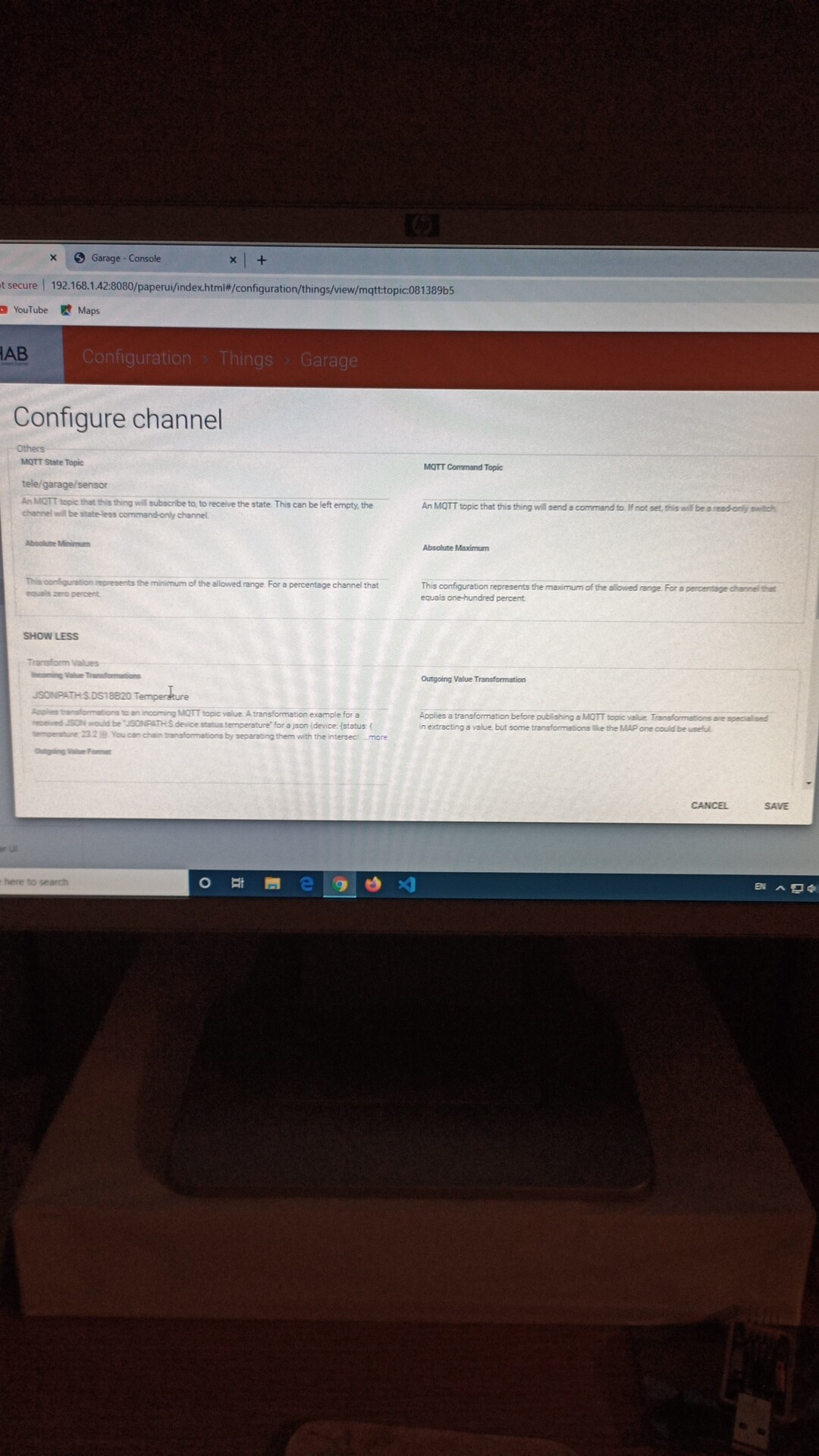

Have set a channel up but need help on the
MQTT state topic and MQTT Command Topic
transform values
Do you need to do both incoming and outgoing?
Is this JSONPATH:$.garage.sensor.temperature
Have added JSONPath transformation

For a sensor you only need a stateTopic, in your case tele/garage/sensor
The incoming transformation would be:
JSONPATH:$.DS20B18.Temperature
Hi tried that and have no temperature reading in the control page
Is the channel meant to be a text or number value.
State topic
tele/garage/sensor
Incoming value transformation
JSONPATH:$.S18B20.Temperature
On sonoff basic Tasmota
tele/garage/sensor has time, Ds18b20, temperature, temp unit

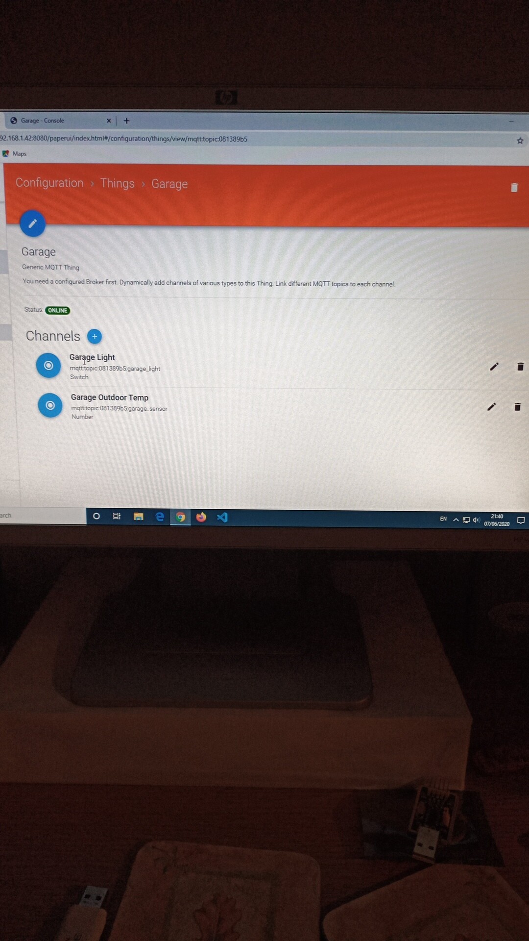

Hi I am right in doing it like this
Generic MQTT Thing
Garage
Channels Garage light and Garage sensor
This is off the same sonoff basic with Tasmota
