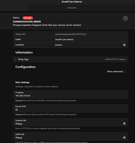

Hello community,
I just buy a new cam
SONOFF CAM GEN 2
It support RTSP.
Indeed I can set it up from the ewelink app and i give back these url from the app:
rtsp://USER:PASS@192.168.178.145:554/av_stream/ch0
I tought i can easilly implement it in my OH enviroment with the IPcamera binding that shuld support RTSP devices but i’m not able to see the stream but i got ERROR on the thing like in the image
HERE the same as the piture above but in CODE

logs says:
INFO	openhab.event.ThingStatusInfoChangedEvent	Thing 'ipcamera:generic:6f1e1811fa' changed from OFFLINE (COMMUNICATION_ERROR): FFmpeg Snapshots Stopped: Check that your camera can be reached. to ONLINE
INFO	openhab.event.ThingStatusInfoChangedEvent	Thing 'ipcamera:generic:6f1e1811fa' changed from ONLINE to OFFLINE (COMMUNICATION_ERROR): FFmpeg Snapshots Stopped: Check that your camera can be reached.
any one have some advise?
Is the binding configuration correct?
ps.
these link says that in other enviroment like HA has been already tested and OK
Link to italian abstract
Video of easy HA integration via RTSP generic stream
Streaming via VLC works with the RTSP url that I also insert in Openhab…but OH have problems to connect the cam. I did not understand what could be the problem
I think ‘snapshot url’ and ‘mjpeg url’ has to be blank
Ffmpeg is not a url.. :man_shrugging:t3:
Did you tried without?

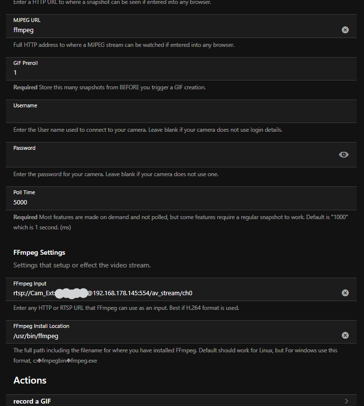

I am pretty sure this is not the default setting, did you change this?
try making this blank as I am pretty sure your camera will be creating a single RTSP feed that is h264 and not in mjpeg format.
No idea where the file:rtsp came from. I recommend you delete the thing and create a new one leaving everything on the defaults. You should only need to provide the FFmpeg Input url, the user and the password and the IP. Also when providing the rtsp://Esterno:PASS@192.168. you can leave the user:pass out.. Use this URL…
rtsp://192.168.178.145:554/av_stream/ch0
This way if you ever change your password it is only in 1 feild and I also believe it removes the password from the logs automatically for you.
