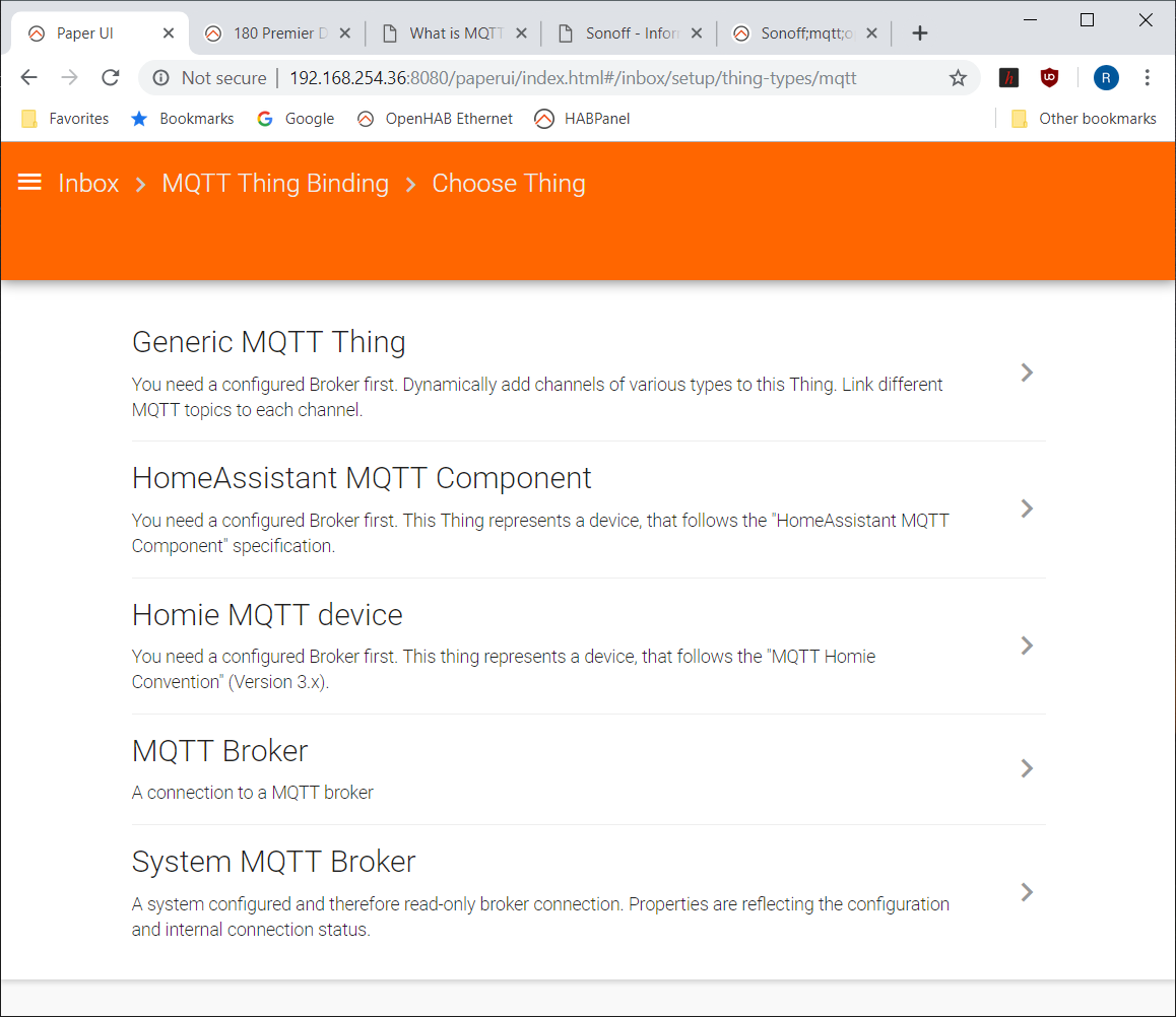

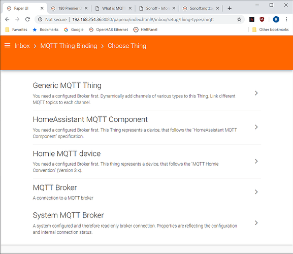

There is a builtin mqtt broker which can be installed from Paper UI (addons → misc) but you can also use mosquitto or even another broker.
To get openHAB connected to your broker you will have to setup the mqtt2 addon (Paper UI → bindings), create a bridge (Paper UI Inbox → + → add mqtt → bridge …) with a connection to your mqtt broker.
And you will need at least one generic mqtt thing (Paper UI Inbox → + add mqtt → generic mqtt thing).

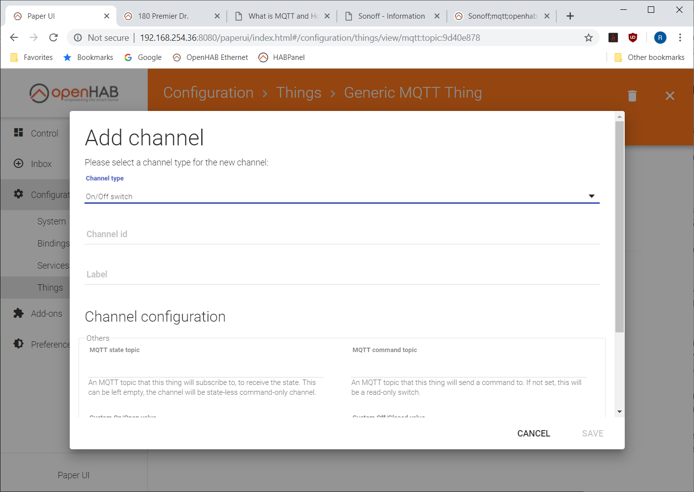

Then add channels to that thing (Paper UI → configuration → Things → the generic mqtt thing created in the last step → add channels with the +)
For each channel setup at least one topic for receive or transmit, this topic is typically in the
form stat/nameOfSonoffThing/POWER for receiving the state
and cmnd/nameOfSonoffThing/POWER for transmitting a command.

Thank you for your reply! This I understand better.
I have had Mosquitto working thanks to "https://www.smarthomeblog.net/mqtt-openhab/ " and tested. This is where I am stumped.
So your information gets me to: Adding a channel.
So where do I find info to fill out the template?
I am in simple mode and there are no items, or do the channels have to be created first?
I am familiar with the differences using OH data base and using file based control. I use VC to do most of my items, thing,rules and sitemap. Luckily for me VC crates the channels which totally baffle me.
Also when selecting a generic thing, there are other option I have been unable to find explanations of those things.
Can you point me ia direction?
Thank you very much for your help. At this time I have a Sonoff Dual flashed with Tasmota and working, but still ??? on some terminology setup issues. like “topic” & “full topic”.
I am an American married to a Chinese wife, I have the same problems with her. ;-). Note and she has with me…
Items get created when a channel is added.
The Channel ID is the name the channel gets identified by openHAB (e.g. to link the channel to an item)
The Label is the default label set for this channel.
MQTT state topic is the topic to get the state of the channel (from your device, so you need to get that information from your device, in general you may have set at least a part of that topic yourself)
MQTT command topic is the same, but the other direction, so when switching in openHAB, a command is sent to that topic. The Broker gets the command and publishes it to your device. The device is switched.
