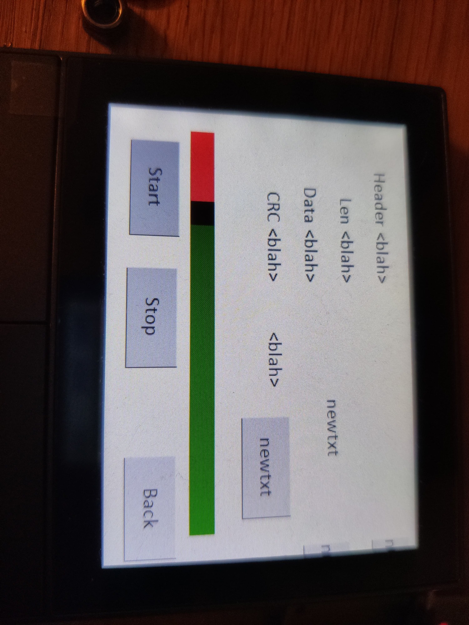

That screen should say something to us?
It was my test one to work out how the packets worked for the advanced comms mode! lol
It’s deleted now in next version. moved on to a test swipe gesture one, which is working now

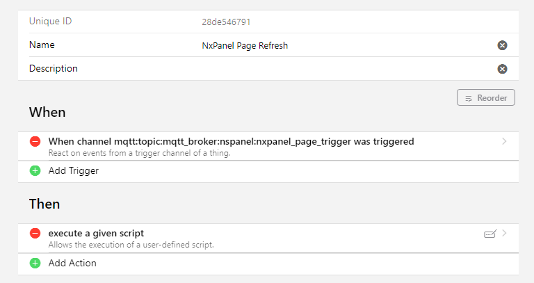

For now here is an almost compete version in which you can actually configure your setup!! :slight_smile:
You need a thing channel and a rule;
  - id: nxpanel_command
    channelTypeUID: mqtt:string
    label: NxPanel Command
    description: ""
    configuration:
      commandTopic: cmnd/nspanel/nxpanel
  - id: nxpanel_page_trigger
    channelTypeUID: mqtt:trigger
    label: NxPanel Page Trigger
    description: ""
    configuration:
      stateTopic: tele/nspanel/RESULT

The above is just a little 2 page example to get the idea.
Make sure you are on latest nxpanel.be & nxpanel.tft
https://github.com/peepshow-21/ns-flash/tree/master/tft
