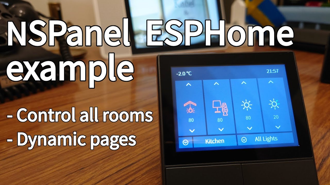

Just wanted to post my current project state plus try and get som help…
I’m an Openhab user using ESPHome. Hope my progress can be of use to someone.
I’ve tried to create something with the main purpose of easy control of lights in all rooms but with the possibility to go deeper into each room to control basically everything. Plus dynamic pages that pop up on special events: Knock on door, coffee brew, deactivate alarm. Use MQTT to communicate with Openhab.
Help is about the fact that I can’t add any more components to the code because that causes the ESP to not boot up. The code compiles and gets uploaded but it then just gets stuck with a flashing first page. Very annoying since I’ve come so far with the project. Flash memory is about 65% use but it feels like it has to much to initiate at boot up so it just gives up. Anyone have any ideas of what the root cause could be?
Yaml and HMI file is uploaded on Github:
https://github.com/lillaeriika/NSPanel
Even though it wouldn’t run, becuase you are ESPHome, have you tried flashing Tasmota and then uploading your TFT with that? You’d at least know if it’s an issue with the TFT or with the ESPHome flashing process.
Im pretty sure it is not a problem with the TFT file. The TFT file works. I haven’t changed that. It is adding code to ESPHome that makes it not boot.
Edit: I’ve done some more investigation. Working theory right now is that I was using retained messages on my MQTT channels in Openhab. I thought that would be a good idea so a newly started panel would get the latest value on all components. But thinking about it I don’t think the ESP likes receiving data from 20 mqtt topics on boot plus a lot of code that is supposed to execute for each received message. At the same time it is trying to initialize every ESP component as well. Looks like I can add some more stuff for the moment at least.

@Erik_Bergstrom Glad it’s going, this is prob not the best thread if you are using ESPHome though, this is really around the Tamsota variant of communication. There are specifc thread based solely around the ESPHome way, you’d probably getter more useful help there.
