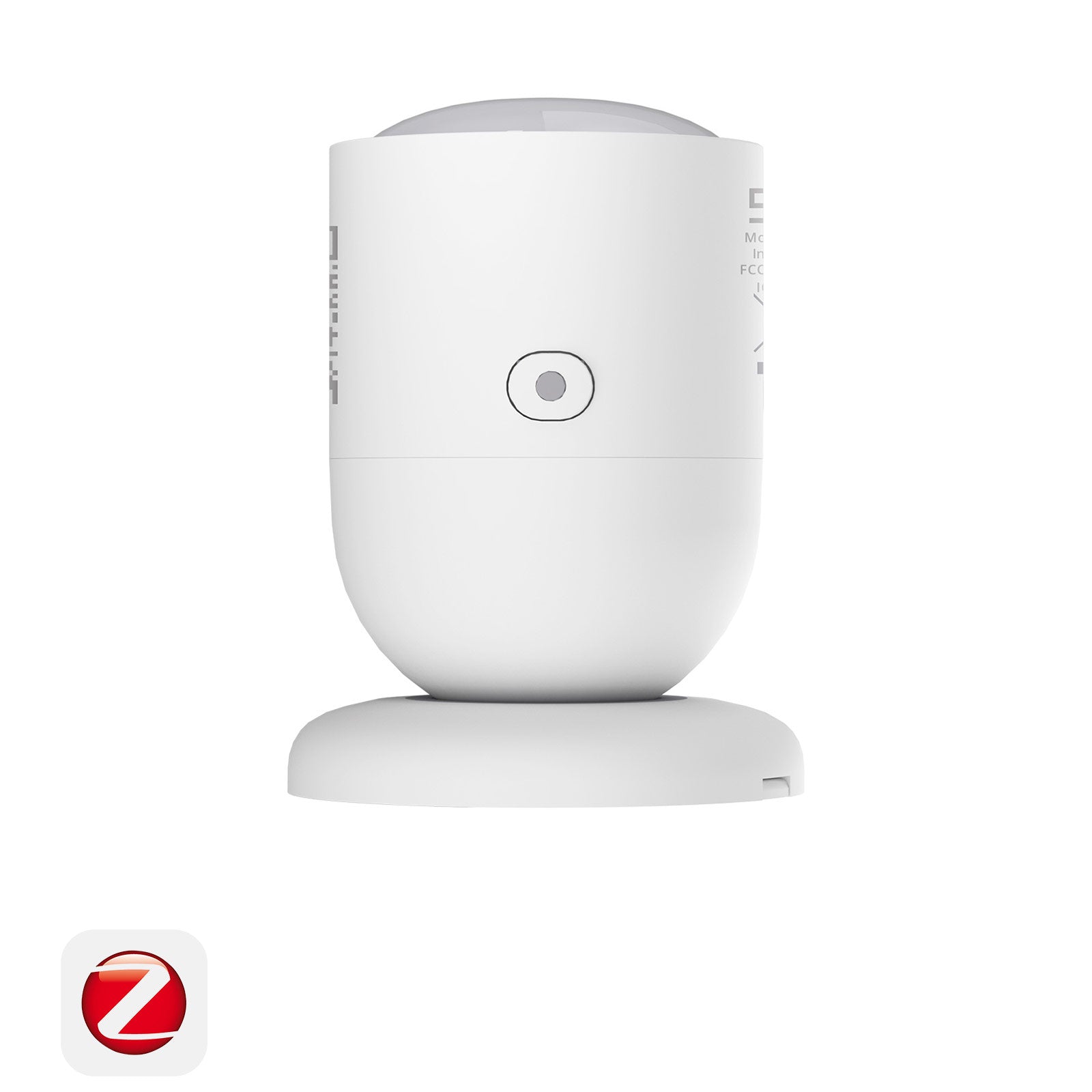

Since there’s been no discussion of the new Sonoff SNZB-06P in the OH community, I thought I’d share my experience as I set up a couple of them.
The first thing to know is that it’s cheap. Sonoff sells them through Walmart Canada’s website, and a three pack is less than CAD$50.
It’s a surprisingly tiny little thing and feels better-built than Sonoff’s battery-powered sensors. I like the magnetic base, which allows the sensor to rotate freely and can be mounted magnetically, with screws, or with an included 3M sticker.
The SNZB-06P comes with a long USB-C cable and only needs 5V/1A, so any old USB adapter should be sufficient. Within a minute of plugging it in, I had it joined to my Zigbee2MQTT network. It also functions as a router to improve a Zigbee mesh network.
As far as detection goes, it feels as fast as a PIR motion sensor. The sensitivity range can be set to 2.5m, 3.5m, or 4m by double-pressing the sensor’s button.
When occupancy is detected, the sensor also reports dim/bright, so that you can trigger a rule on occupancy and light level. I wish it reported actual lux levels continuously, but in most cases this would be sufficient.
Note that you need to be on Zigbee2mqtt v1.35.2 to access light levels (and get a few fixes). You can see all of the Z2M settings on their SNZB-06P page.
The challenge is going to be finding the right places to put the sensors, because they can see through non-metal objects (e.g. walls), and will pick up anything that moves (e.g. fans, curtains, pets). Unlike a PIR sensor, you can’t strategically block a radar-based presence sensor with furniture.
Questions? Let me know if there are any scenarios you’d like me to test.

I placed a sensor on my dresser, pointing toward my bed. When I laid down, I was in line with the sensor with my feet closest to it and my head farthest away. This was asking a lot, because I presented almost no cross-section of my body to it. I was just curious if it was sensitive enough to pick me up based on just my breathing. Answer: it is not. I was practically invisible to it.
I think this is a good thing. If it were too sensitive, there would be a lot of false positives.
I then moved the sensor up over the door next to my dresser, so that it could see more me. This worked very well, and may end up being its permanent home. The included 6ft USB cable is just long enough to reach from the outlet next to the door.

These sensors have worked pretty well for me so far, but there have been a couple of times when one of them has gotten stuck in the Occupied state. The only way I can figure out to reset it is to change the timeout in Zigbee2mqtt. It’s not a big deal, but a bit of a concern.

One of my two sensors has gotten stuck in an Occupied status a couple of times, and I’ve just unplugged it to reset. I couldn’t say why it happened, and didn’t look into it any further. I don’t see any reason for it to be related to temperature.
I re-paired mine. Pairing works fine. It does detect me and turns occupancy ON but it then remains ON no matter what.
I tried re-pairing, resetting, I tested in rooms where there is NO WAY to be anything trigerring the device… no matter what, it latches on ON and stays there now…
I contacted itead, let’s see what they say.
I actually had this happen earlier this week. It was late at night, so I just left it alone. I forgot about it the next morning and when I checked later in the day it was working again.
My office desk is in front of the sensor, so I would have been sitting in front of it for most of the day. This makes me think that the sensor needed a long period of actual occupancy to correct itself, and then cleared when I walked away.
So, you might want to try sitting in front of it for awhile and then leaving the room.
I am also stting in from of it. It never latches OFF now.
I even tried to point it to an empty space and do an init. It latches ON instantly and never comes back.
I am in touch with itead… let’s see. For now, the sensor is un-usable.
Update on the topic: iTead has been actually very supportive on the issue. Shipping takes time but they make it very smooth.
I got a replacement for my sensor and the new one does unlatch as it should. Just as the original one initially. So I guess the first one got an issue. I am ok with sensors having issues as long as manufacturers/resellers make it easy to get those fixed/replaced.
I also think those sensors really do not like vibrations (ie being stuck to a device with a fan that could be vibrating).
I am not sure how you guys update the firmwares on those devices. I asked iTead/Sonoff what my options would be in that case.
iTead is also supposed to have a look at my defective sensor and I asked them if the issue could be fixed by the user (I tried a reset…). That would be a better option than having to ship and wait for a replacement.
