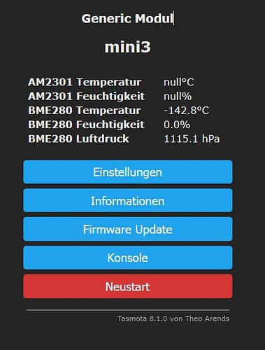

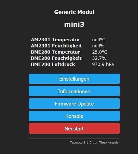

As Vincent said pls. check your connections first. I made some tests with a d1 mini, flashed with tasmota 8.1
no connection/bad connection will show you something like this in WevUI(don’t note AM2301):

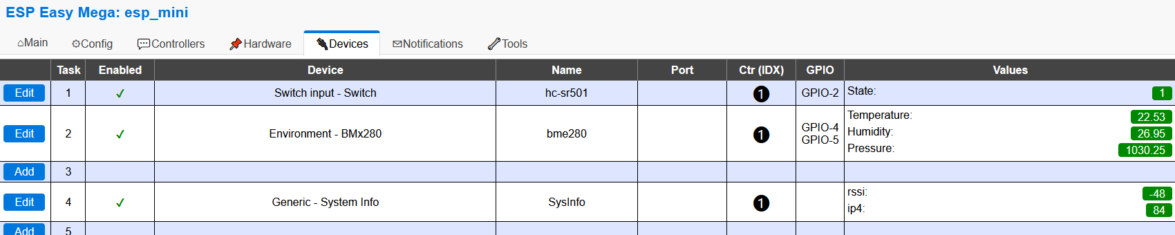

As mentioned check the connections and if you still have issues try flashing one of the Sonoff devices with EspEasy firmware to see if that makes a difference. I have the same sensor and it works fine with EspEasy.
