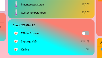

HERE THE WORKING SOLUTION
UID: mqtt:topic:f4f35e27dd:SchalterBuero
label: Licht Buero
thingTypeUID: mqtt:topic
configuration:
payloadNotAvailable: Offline
availabilityTopic: tele/Tasmota2OG/LWT
payloadAvailable: Online
bridgeUID: mqtt:broker:f4f35e27dd
location: Buero
channels:
  • id: Power
    channelTypeUID: mqtt:switch
    label: Power
    description: “”
    configuration:
    commandTopic: cmnd/Tasmota2OG/ZbSend
    formatBeforePublish: ‘{“Device”:“0x404D”,“send”:{“Power”:%s}}’
    stateTopic: tele/Tasmota2OG/SENSOR
    transformationPattern:
    - JSONPATH:$[“SchalterBuero”].Power
    off: “0”
    on: “1”
