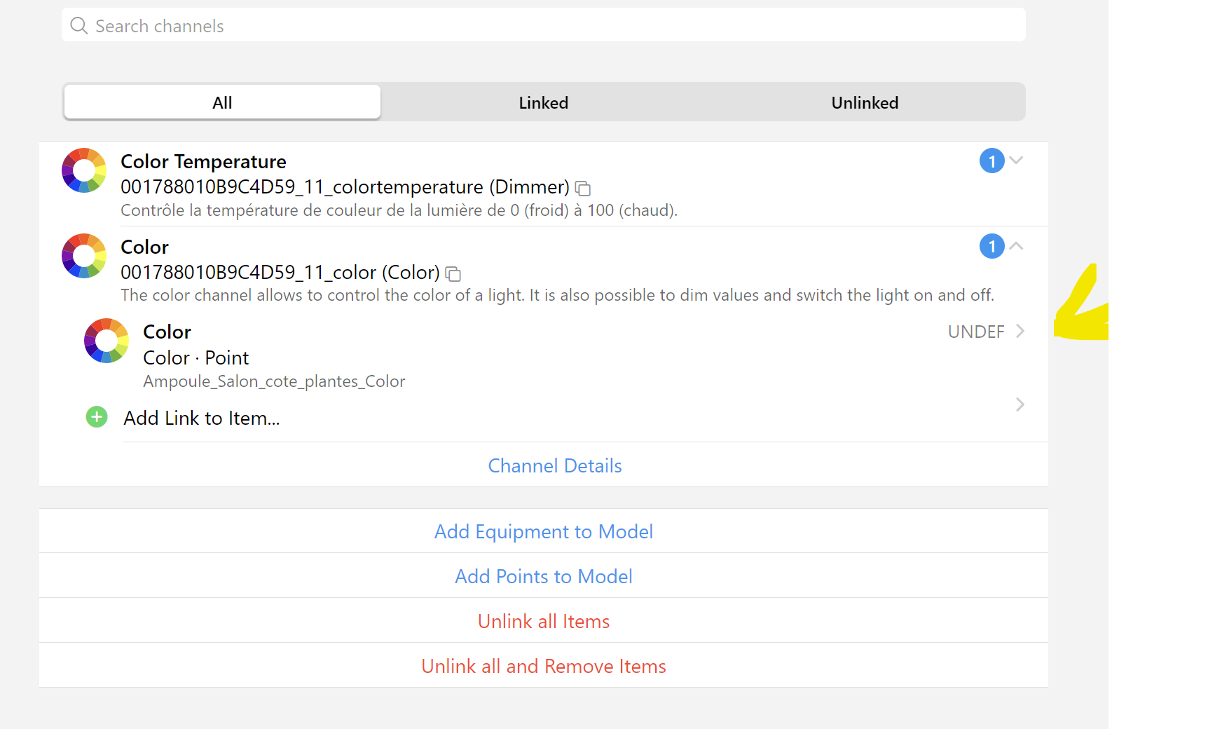

  • Issue of the topic: Color model is shown as UNDEF, while Color temperature is working as expected
  • Bulb model : LCA004
  • firmwareVersion : 0x01001E0A (normally lastest)
  • Zigbee Coordinator : SonOff EFR32MG21, normally up to date (6.10.3.0)
Here i can see UNDEF, instead of the Color point control :
How to get specific zigbee logs ?
Any idea to make it work ?

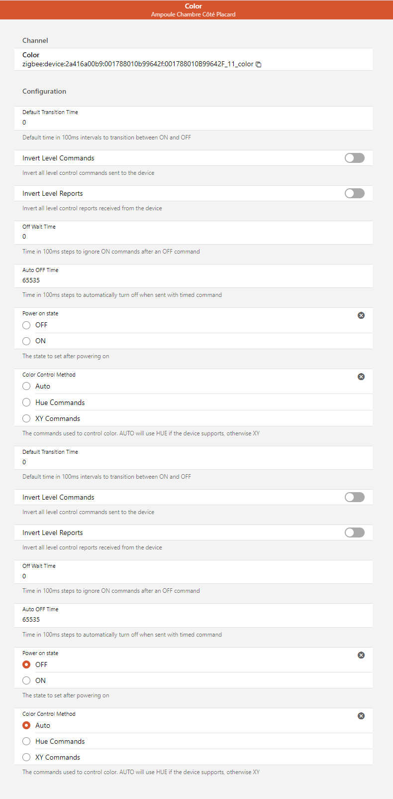

Are there channel options you could try (‘behind’ Channel Details)?
Re logs: ZigBee - Bindings | openHAB
yes i have these options :
I tried to change some, but nothing work better.
One thing i have success is to change Model => Color => Semantic Property to Co2 for example, then to None and the color picker appear and i’m temporary able to send commands.
But the whole installation is very unstable. It work like 5mn, then stop working.
