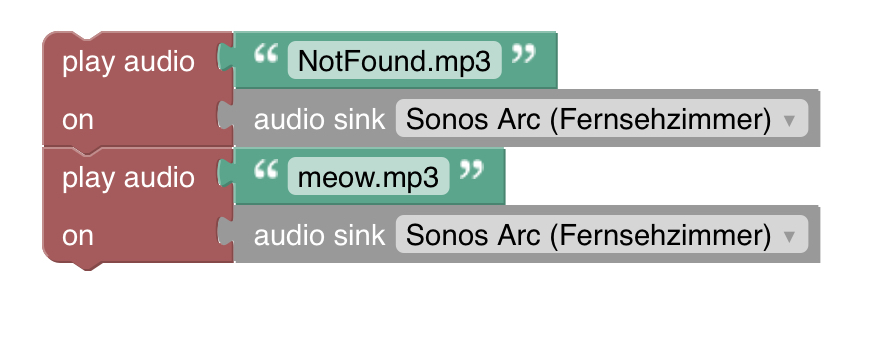

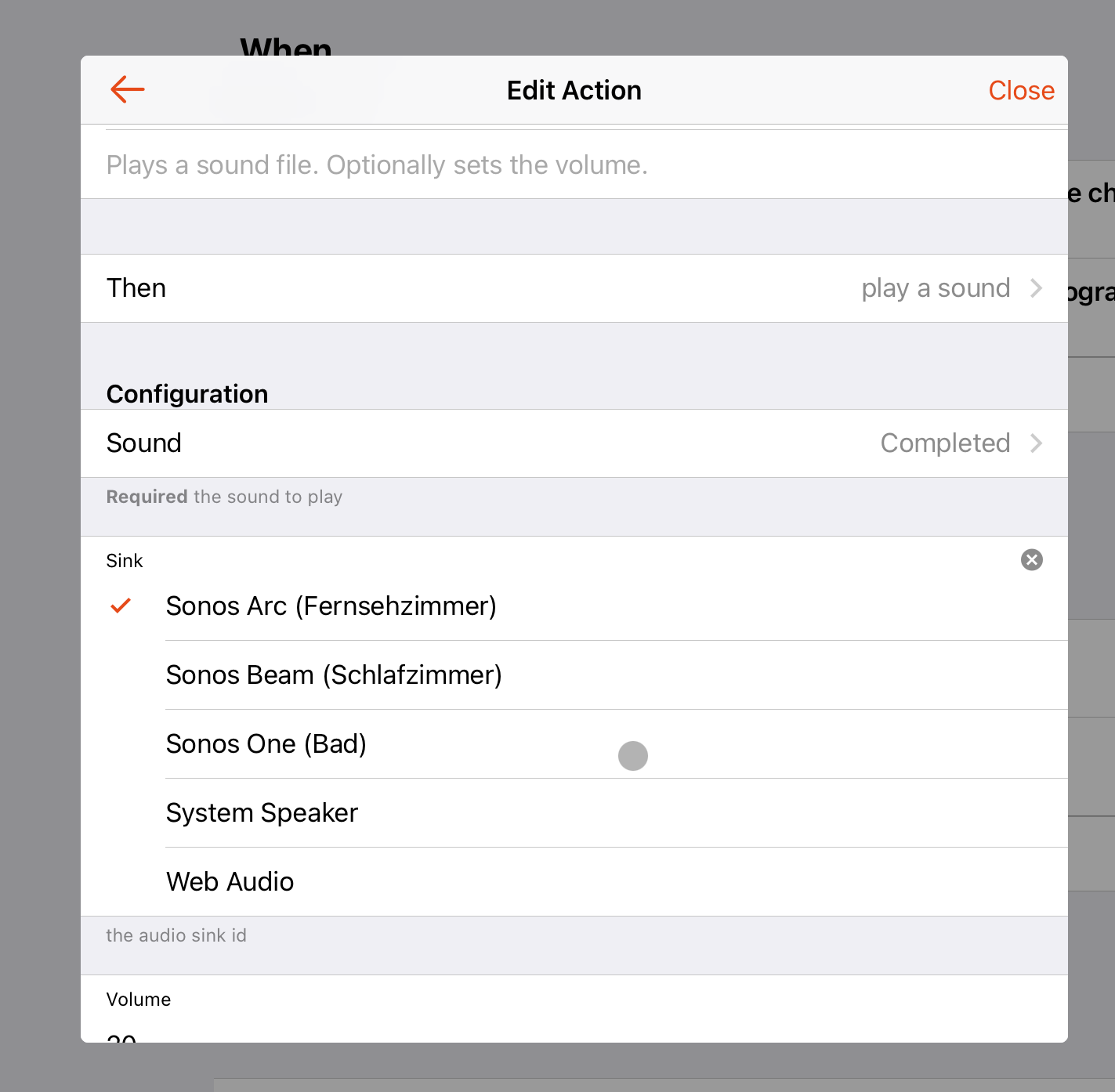

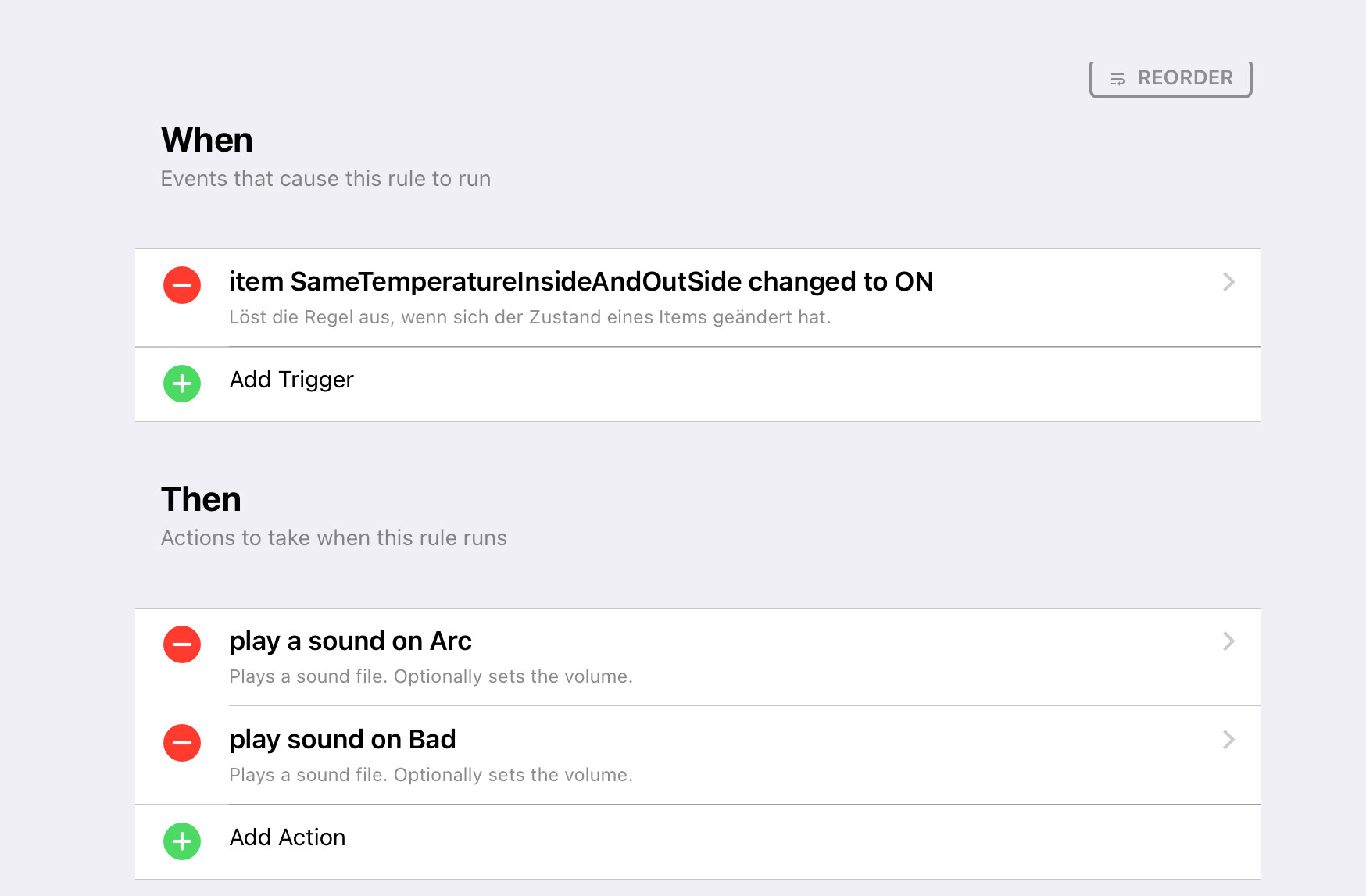

Before (see the picture) completed was played with volume 20.
now it is setting the Sonos to mute and that‘s it.
Any ideas?
‚Update:

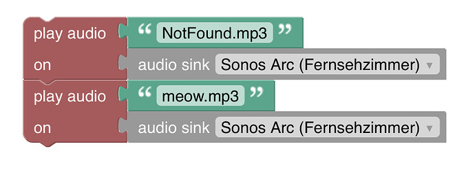

Also this is not working:
IMG_0939
There is a file not found exemption in the log for the first one, but the second one just mutes:
2025-07-23 10:39:25.797 [WARN ] [nhab.core.model.script.actions.Audio] - Failed playing audio file: File ‘/openhab/conf/sounds/NotFound.mp3’ not found!

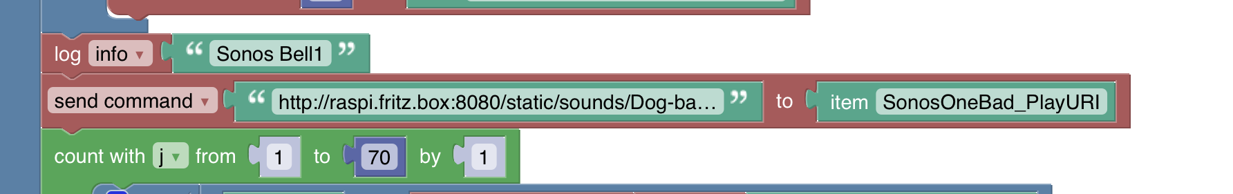

I assume there is an issue with the Sink sink because PlayUri like this is working fine:

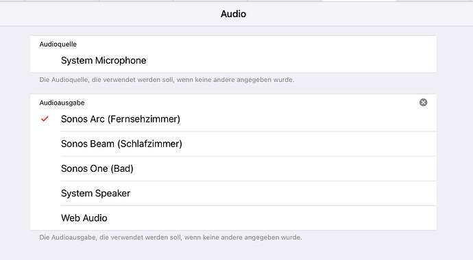

2. For the default settings of the sink:
Setting in the default speaker in the gui had no effect. settings → System → Audio
If i enter the screen again I still see nothing checked. After rebooting.
But setting the the value in the runtime.cfg
org.openhab.audio:defaultSink=org.openhab.audio.sonos:Arc:RINCON_38420B472DBC0XXXX
it seems to work. But allows then only to play on this singe Sonos. Setting a different one does not work simply said this only plays on ARC.
