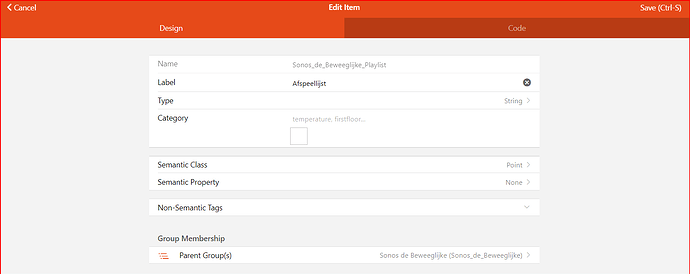

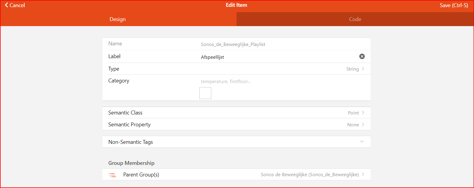

This is the item:
label: Afspeellijst
type: String
category: ""
groupNames:
  - Sonos_de_Beweeglijke
tags:
  - Point

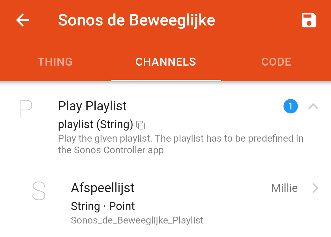

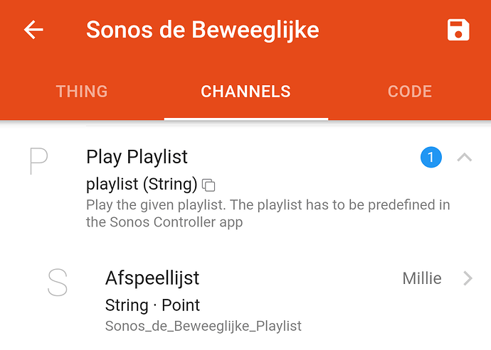

This item is linked to this channel:
Does anyone recognize this behavior? Or even better: know a solution?
If you are using the same account the music will stop. If you have something like Spotify family you can easily create more accounts. Set up a separate account for Sonos.
