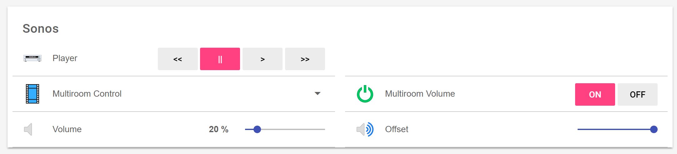

Player inactive:

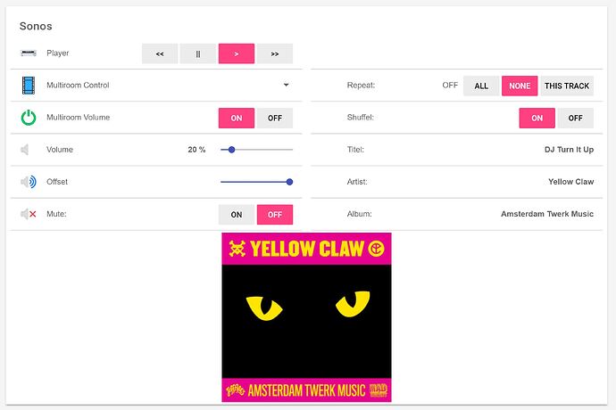

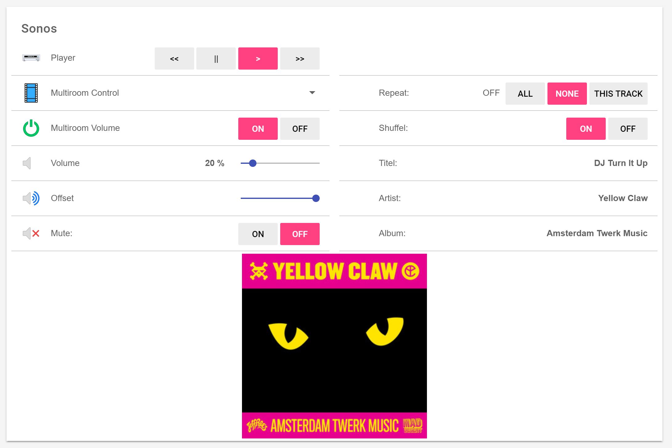

Player active
Multiroom Control options:
MultiroomControl
Frame label="Sonos"{
		Default item=SonosLivingroom_Control label="Player" icon="player"
		Text icon="none"
		Selection item=SonosMultiroom label="Multiroom Control"  icon="mediacontrol" mappings=["Multiroom/MultiroomVolume/Devices=Livingroom"="Add to/Create Multiroom Group",
			"Standalone/Devices=Livingroom"="Set to Standalone", "MultiroomTarget/DefaultVolume/Devices=Livingroom/Bedroom"="Add Bedroom to Group",
			"MultiroomTarget/Devices=Livingroom/Bathroom"="Add Bathroom to Group", "EnableMultiroomVolume/Devices=Livingroom"="Enable Multiroom Volume",
			"DisableMultiroomVolume/Devices=Livingroom"="Disable Multiroom Volume"]
		Switch item=SonosLivingroom_Repeat label="Repeat: " visibility=[SonosLivingroom_Control=="PLAY"] mappings=[ALL="All", OFF="None", ON="This track"]
		Switch item=SonosLivingroom_MultiroomVolume label="Multiroom Volume" mappings=[ON="On", OFF="Off"]
		Switch item=SonosLivingroom_Shuffle label="Shuffel: " visibility=[SonosLivingroom_Control=="PLAY"] mappings=[ON="On", OFF="Off"]
		Slider item=SonosLivingroom_Volume label="Volume" icon="soundvolume"
		Text item=SonosLivingroom_CurrentTitle label="Titel: " visibility=[SonosLivingroom_Control=="PLAY"]
		Slider item=SonosLivingroom_Offset label="Offset" icon="soundvolume"
		Text item=SonosLivingroom_CurrentArtist label="Artist: "  visibility=[SonosLivingroom_Control=="PLAY"]
		Switch item=SonosLivingroom_Mute label="Mute: " visibility=[SonosLivingroom_Control=="PLAY"] mappings=[ON="On", OFF="Off"]
		Text item=SonosLivingroom_CurrentAlbum label="Album: "  visibility=[SonosLivingroom_Control=="PLAY"]
		Image item=SonosLivingroom_CurrentAlbumArt label="Cover" visibility=[SonosLivingroom_Control=="PLAY"]

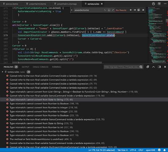

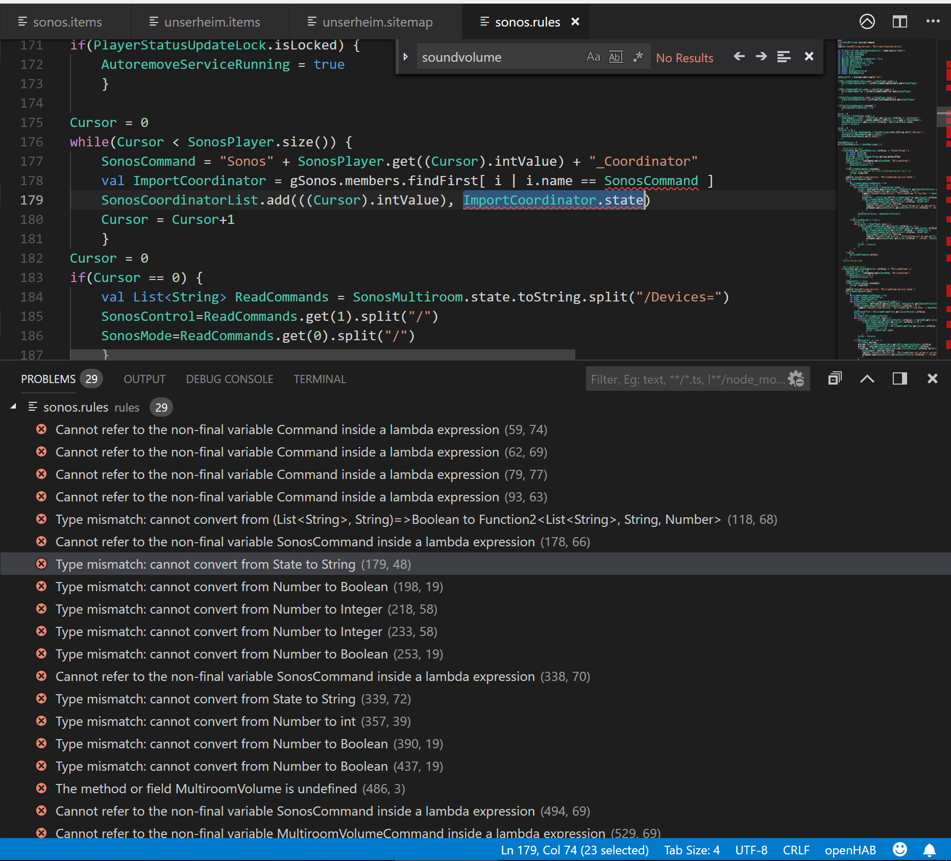

Now you are almost done. The last thing is the rule file. In this you have to define for each Room (like Livingroom), the room name and the uuri of the sonos player. Therefore search for the field SonosPlayer and SonosUURI, they are in the User Input section. Then add each Player and uri separated. I is important that the uuri and the playername are on the same position in the array. One example with three rooms is available in the rule. Just replace the three rooms with your rooms, of yourse you can add so many rooms like you need. Then you have to define a default volume for each hour in the DefaultVolume array. The first entry is for 00:00, the next entry for 01:00, 02:00…23:00 so you should have 2 entries. As last step you have to define the default play uri that should be used if no zone is active. I used a radio uri.
The rule will be splitted in two parts, because it is to big for one post:
import java.util.List

rule "Sonos Multiroom"
Item SonosMultiroom received command
logInfo("SonosMultiroom.Service", "Multiroom Steuerung active")
var ArrayList<String> SonosCoordinatorList = newArrayList("empty")
var List<String> SonosControl
var List<String> SonosMode
var String SonosCommand
var Boolean AutoremoveServiceRunning = false
var Boolean JobSuccesfull = false
var Boolean MultiroomForced = false
var Boolean ResetCursor = false
var Number CursorPointer
var Number Cursor
var Number SonosControlCursor
var Number SonosModeCursor
JobSuccesfull = prerequiremets.apply("run")
if(MultiroomVolumeAvailable.size() < SonosPlayer.size()) {
	MultiroomVolumeAvailable = initMultiroomVolumeAvailable.apply(SonosPlayer)
if(MultiroomVolumeOffset.size() < SonosPlayer.size()) {
	MultiroomVolumeOffset = initMultiroomVolumeOffset.apply(SonosPlayer)
if(PlayerStatusUpdateState.size() < SonosPlayer.size()) {
	PlayerStatusUpdateState = initPlayerStatusUpdateState.apply(SonosPlayer)
if(PlayerStatusUpdateLock.isLocked) {
	AutoremoveServiceRunning = true
Cursor = 0
while(Cursor < SonosPlayer.size()) {
	SonosCommand = "Sonos" + SonosPlayer.get((Cursor).intValue) + "_Coordinator"
	val ImportCoordinator = gSonos.members.findFirst[ i | i.name == SonosCommand ]
	SonosCoordinatorList.add(((Cursor).intValue), ImportCoordinator.state)
	Cursor = Cursor+1
Cursor = 0
if(Cursor == 0) {
	val List<String> ReadCommands = SonosMultiroom.state.toString.split("/Devices=")
	SonosControl=ReadCommands.get(1).split("/")
	SonosMode=ReadCommands.get(0).split("/")
SonosModeCursor = 0
while(SonosModeCursor < SonosMode.size()) {
	//DefaultVolume Start
	if(SonosMode.get((SonosModeCursor).intValue) == "DefaultVolume") {

Can you post an image of your site map?
Sounds like a good solution to the sonos app
I have just uploaded them
@buschif4 - OFF TOPIC:
Hah! Funny you have Yellow Claw playing on your screenshots. Saw them recently live in Cologne… :wink:

Thank you so much for the items, sitemap and rule. I just started to use it in my setup. and there were two things bothering me:
  1. I did get some errors while playing the last In.tune radio station:
21:28:56.430 [INFO ] [smarthome.event.ItemStateChangedEvent] - SonosLivingroom_Control changed from PLAY to PAUSE
21:28:56.486 [ERROR] [.ui.internal.items.ItemUIRegistryImpl] - Cannot retrieve item 'SonosLivingroom_CurrentTitle' for widget org.eclipse.smarthome.model.sitemap.Text
21:28:56.602 [ERROR] [.ui.internal.items.ItemUIRegistryImpl] - Cannot retrieve item 'SonosLivingroom_CurrentTitle' for widget org.eclipse.smarthome.model.sitemap.Text
21:28:56.672 [ERROR] [.ui.internal.items.ItemUIRegistryImpl] - Cannot retrieve item 'SonosLivingroom_CurrentTitle' for widget org.eclipse.smarthome.model.sitemap.Text
21:28:56.747 [ERROR] [.ui.internal.items.ItemUIRegistryImpl] - Cannot retrieve item for widget org.eclipse.smarthome.model.sitemap.Text
21:28:56.807 [ERROR] [.ui.internal.items.ItemUIRegistryImpl] - Cannot retrieve item 'SonosLivingroom_CurrentArtist' for widget org.eclipse.smarthome.model.sitemap.Text
21:28:56.874 [ERROR] [.ui.internal.items.ItemUIRegistryImpl] - Cannot retrieve item 'SonosLivingroom_CurrentArtist' for widget org.eclipse.smarthome.model.sitemap.Text
21:28:56.943 [ERROR] [.ui.internal.items.ItemUIRegistryImpl] - Cannot retrieve item 'SonosLivingroom_CurrentArtist' for widget org.eclipse.smarthome.model.sitemap.Text
21:28:57.012 [ERROR] [.ui.internal.items.ItemUIRegistryImpl] - Cannot retrieve item for widget org.eclipse.smarthome.model.sitemap.Text
21:28:57.072 [ERROR] [.ui.internal.items.ItemUIRegistryImpl] - Cannot retrieve item 'SonosLivingroom_CurrentAlbum' for widget org.eclipse.smarthome.model.sitemap.Text
21:28:57.163 [ERROR] [.ui.internal.items.ItemUIRegistryImpl] - Cannot retrieve item 'SonosLivingroom_CurrentAlbum' for widget org.eclipse.smarthome.model.sitemap.Text
21:28:57.266 [ERROR] [.ui.internal.items.ItemUIRegistryImpl] - Cannot retrieve item 'SonosLivingroom_CurrentAlbum' for widget org.eclipse.smarthome.model.sitemap.Text
21:29:33.447 [INFO ] [e.model.script.SonosMultiroom.Service] - MultiroomVolume Service locked.
21:29:34.528 [INFO ] [e.model.script.SonosMultiroom.Service] - Initialise Sonos Multiroom Service
21:29:34.816 [INFO ] [e.model.script.SonosMultiroom.Service] - Multiroom Volume is inactive in Zone Livingroom.
21:29:34.931 [INFO ] [e.model.script.SonosMultiroom.Service] - Multiroom Volume Service unlocked.
  1. I am using Visual Studio Code with OpenHab extension to edit the rules. There are currently about 29 warnings / errors reported, but I am not sure on the severity of those. In the screenshot below I’ve just selected one Type mismatch warning:
Any ideas and recommendations would be very much appreciated.
