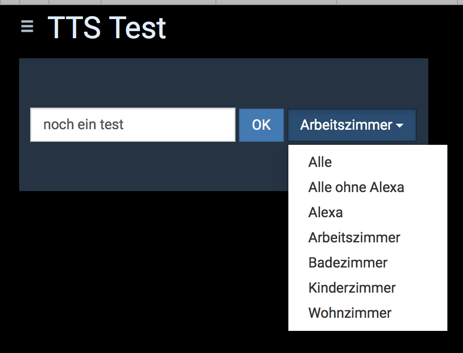

works peferctly:
I havent implemented every room-setting yet.
Still I lack a solution for playback on all sonos-devices :slight_smile:
