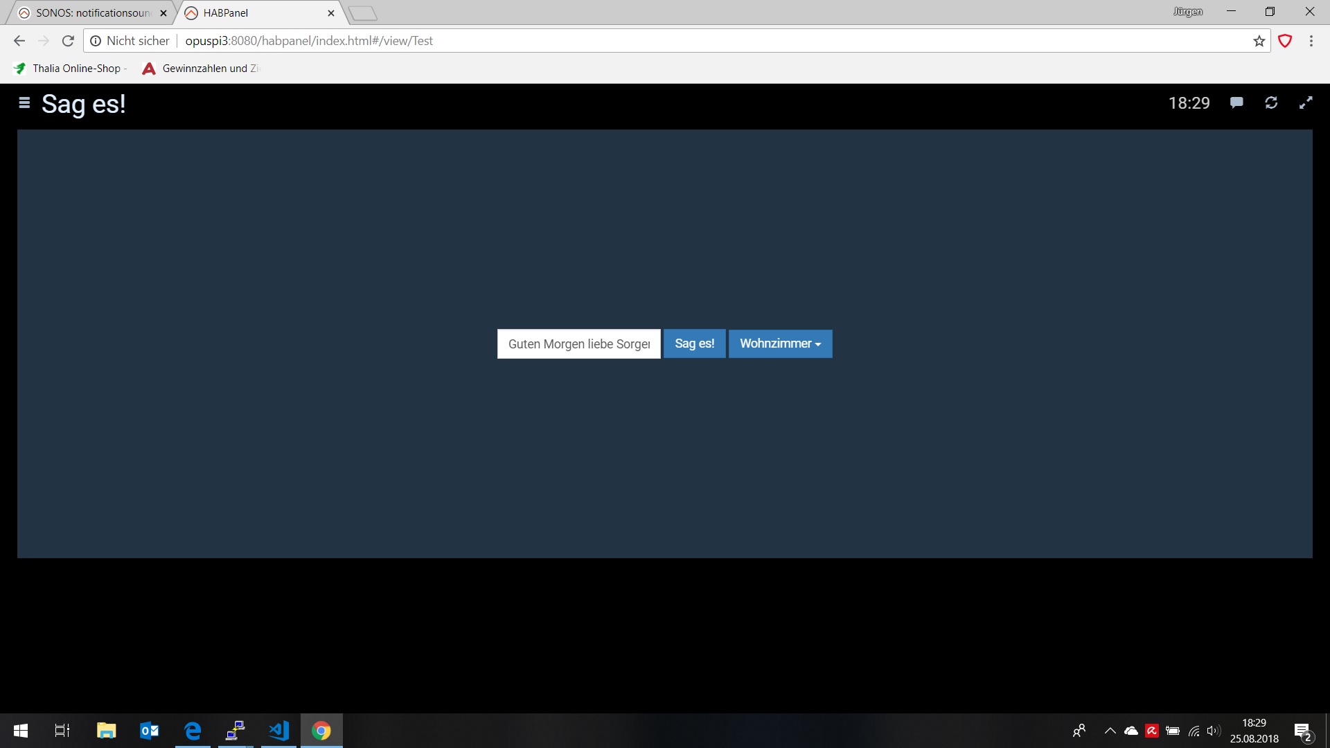

Yes, all my Sonos Boxes are setup via PaperUI, therefore they are identified as an AudioSink and can be selected on PaperUI as the default sink for example.
I’m using a rule like (although the useage of NotificationVolume is still as in the older version of the Sonos Binding ) :
val Number NotificationVolume = 20
rule "SagEtwas"
  Item SayCommand received update
  var String AudioSink
  switch AudioSink {
    case Lautsprecher.state.toString=="Küche" : AudioSink="sonos:PLAY1:RINCON_B8E937E0C16201400"
    case Lautsprecher.state.toString=="Wohnzimmer" : AudioSink="sonos:PLAY1:RINCON_B8E937BDEF0E01400"
    case Lautsprecher.state.toString=="Büro" : AudioSink= "sonos:PLAY1:RINCON_949F3E7D2EF401400"
    case Lautsprecher.state.toString=="Gästezimmer" : AudioSink= "sonos:PLAY1:RINCON_B8E937E0C14201400"
    default:AudioSink="sonos:PLAY1:RINCON_B8E937BDEF0E01400"
  gPlayer_NotificationVolume.allMembers.filter(s | s.state!=NotificationVolume ).forEach [item | item.sendCommand(NotificationVolume)]
  say(SayCommand.state.toString,"voicerss:deDE",AudioSink)
  logInfo("SayCommand","Es ist alles gesagt!")
The item “Lautsprecher” holds a string with the human readable name of the box, the item SayCommand holds the string that should be said. The “Lautsprecher” gets gets selected on a HABPanel dashboard as well as the “SayCommand” string gets set on there.

very nice! Ive already implemented the solution suggested here:
And wrote a quick and dirty Alexa-based rule (Kida are going mad :slight_smile: ).
How did you achieve it in habpanel?
That’s the code in my widget.
<div class="form-inline">
  <div class="form-group">
    <input type="text" class="form-control" no-snap-drag="true"
           ng-model="myvalue" ng-value="itemValue('SayCommand')"></input>
    <button type="button" class="btn btn-primary"
           ng-click="sendCmd('SayCommand', myvalue)">Sag es!</button>
  </div>
  <div class="btn-group" uib-dropdown>
  <button id="single-button" type="button" class="btn btn-primary" uib-dropdown-toggle>
    {{itemValue('Lautsprecher')}} <span class="caret"></span>
  </button>
  <ul class="dropdown-menu" uib-dropdown-menu role="menu" aria-labelledby="single-button">
    <li role="menuitem"><a ng-click="sendCmd('Lautsprecher', 'Küche')">Küche</a></li>
    <li role="menuitem"><a ng-click="sendCmd('Lautsprecher', 'Wohnzimmer')">Wohnzimmer</a></li>
    <li role="menuitem"><a ng-click="sendCmd('Lautsprecher', 'Gästezimmer')">Gästezimmer</a></li>
		<li role="menuitem"><a ng-click="sendCmd('Lautsprecher', 'Büro')">Büro</a></li>
</div>
… although my kids are old enough to pull the power plug :face_with_raised_eyebrow:
