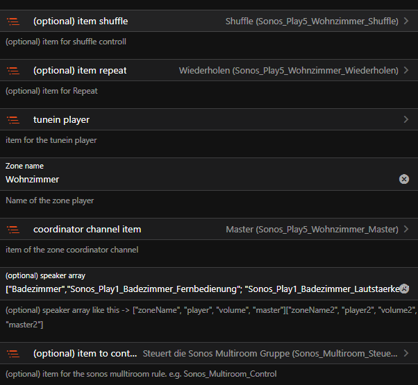

You can just copy my code below in a new widget. When you run the widget you can provide all items to it. as speaker array you need to provide your details in the following format. The speakers must be provided in the following format. Please ensure that the " around the item is still there. (The zoneName and all items inside the zoneArray must have the same name as provided in the linked multiroom rule.)
  • [“<zoneName>”, “<.._player>”, “<.._volume>”, “<.._coordinator>”]
An example for the speaker array is below.
  • [“living room”; “Sonos_livingroom_player”; “Sonos_livingroom_volume”; “Sonos_livingroom_coordinator”][“bed room”, “Sonos_bedroom_player”; “Sonos_bedroom_volume”; “Sonos_bedroom_coordinator”]
If you are using my sonos multiroom volume rule you should provide as volume item the zoneVolume item that was created for the rule. (Only on the item selector if the widget. Inside the item array keep the original volume item so that the widget can control both.)

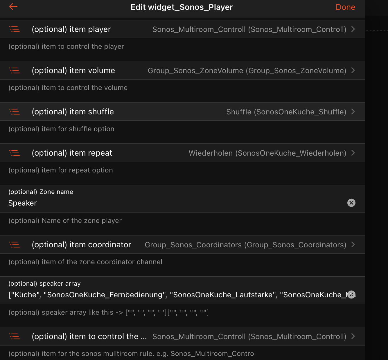

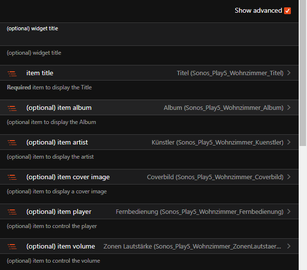

Hello Flo,
I really like this widget. Thanks for sharing it here.
Just some quick notes from my setup procedure:
  • The speaker array that has to be put in the widegt configuration does not like the ‘“’ and ‘”’ characters that are used in the community here. So make sure to use the " character yourself when writing the array.
  • The widget configuration is asking for a “master channel item”. I had to browse through the code to figure out what kind of item was needed here: the coordinator. So maybe change this field to something like “item of the zone coordinator”.

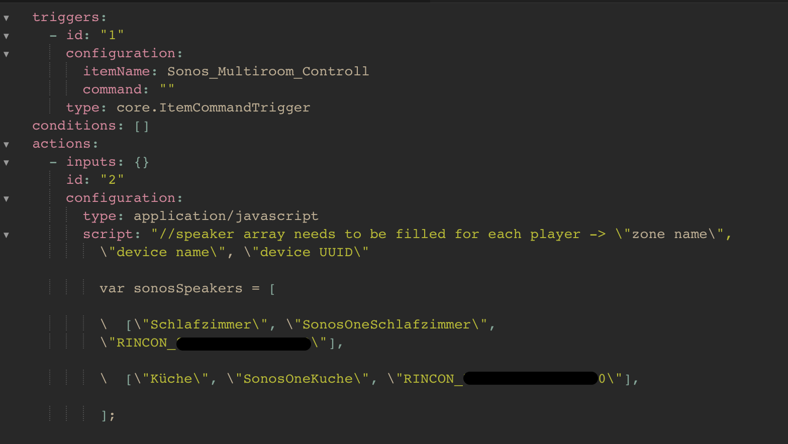

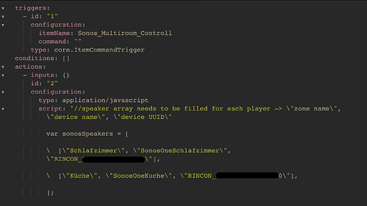

  • In the widget code, the actionItem is still set to Sonos_Multiroom_Steuerung in multiple places. I changed it to the name of my multiroom control item manually. Maybe it could also be set with the configuration?
After that, it works quite well. I am just having some trouble with the zone volume control. But here, I am not sure whether it’s my mistake. It’s updating when I change individual volumes, but the individual volumes do not update when I change the zone volume. I will let you know once I fixed that.
By the way: when not using dark mode, the volume control and zone selection show a small border. In dark mode, these borders are not as visible. But maybe it can be fixed to show no borders at all.
Once again, thanks for your contribution.

So I did all the steps of your first post for rule 1 and 3. rule 2 I skipped for the moment and implemented the widget. Problem is, the widget is not working as it should. I see the speaker, but can’t select one. If I click on the volume, the whole screen is grey, but I can’t select any slider.
I will post my configuration, maybe you can help me out with this…
I defined the players. My standard player items name is SonosOneKuche e.g.

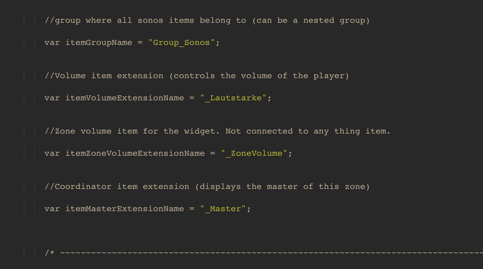

I changed then the rule based on my items:
e.g. SonosOneKuche_Lautstärke (for the volume item)

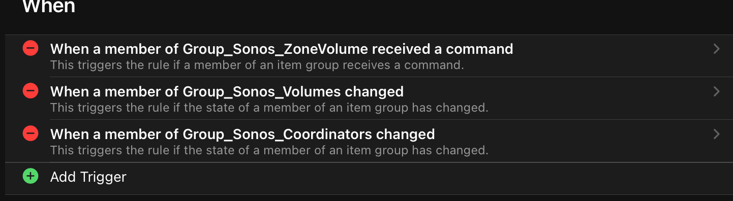

For the trigger I entered the volume created based on your point 3, the Sonos_Multiroom_Controll item.
Next rule was the one for the volume control. I entered here the content according to the what I have. The one Group_Sonos item as well as the other items e.g. SonosOneKuche_ZoneVolume.
Triggers as shown here
I grouped all the items as requested, but I can’t control the widget. I can open the speaker menu, but can’t select a speaker. I can click on volume, but only my display greys a bit, nothing happens. My definition:
I am really a bit lost, where my mistake could be. I guess it should be somewhere in the rule adjustment.
Thank you in advance.

Hi Woogi, from what I can see i think the item definition of the widget is wrong.
You selected the group items on the widget as item channel. This is not working. Please define the items from the main speaker.
Let me give you an german example from my setup :wink:

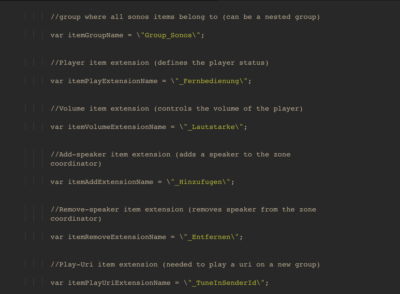

Hello @buschif4,
Thank you for your widget! But I have some problems to get the m ultiroom rule running. I have everything configured like mentioned in your post. I can group players but I get no hook beside the added room. Addionally nothing happens if I click on the volume to change it for the grouped players. The log show nothing… Any idea or hint? Here my config of the rule:
var sonosSpeakers = [
  ["Schlafzimmer", "SonosPlay3Schlafzimmer", "RINCON_XXX"],
  ["Wohnzimmer", "SonosPlaybarWohnzimmer", "RINCON_XXX"],
  ["Küche", "SonosMoveKuche", "RINCON_XXX"]
//default volume in hours
var defaultSpeakerVolume = [8, 8, 8, 8, 8, 8, 8, 10, 12, 14, 16, 18, 18, 20, 20, 20, 20, 18, 18, 16, 14, 12, 10, 8]
//default play uri can pe a uri or tunein station id depending of the playuri item
var defaultPlayUri = "24878"
//group where all sonos items belong to (can be a nested group)
var itemGroupName = "Group_Sonos";
//Player item extension (defines the player status)
var itemPlayExtensionName = "_Fernbedienung";
//Volume item extension (controls the volume of the player)
var itemVolumeExtensionName = "_Lautstarke";
//Add-speaker item extension (adds a speaker to the zone coordinator)
var itemAddExtensionName = "_Hinzufugen";
//Remove-speaker item extension (removes speaker from the zone coordinator)
var itemRemoveExtensionName = "_Entfernen";
//Play-Uri item extension (needed to play a uri on a new group)
var itemPlayUriExtensionName = "_TuneInSenderId";
//var itemPlayUriExtensionName = "_URIabspielen";
//Standalone item extension (needed to remove player if this is the coordinator in a multiroom zone)
var itemStandaloneExtensionName = "_StandAlone";
//Coordinator item extension (displays the master of this zone)
var itemMasterExtensionName = "_Master";
Thank you for your help.
@DocBrown thanks for sharing this. I see the issue but for me it is not clear why this happens. Can you share the YAML code of your widget configuration. So e.g. the YAML of your “Sonot test 2” tab page.
I think then I can understand it better and probably also provide you a solution :wink:
