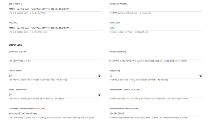

Sorry it took me a bit to reply. Make sure your refresh parameter is a non-zero (and something reasonable - it’s specified in seconds). Basically with TVs - the values will only be updated on a refresh…
If you do have a good value, I’ll likely need a debug log from you to see what’s happening…
