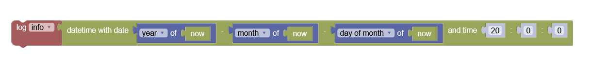

Yes this can easily be done with blockly. See here:
Edit: Did not see that you need it for DSL rules.
For this I don’t have an idea.
