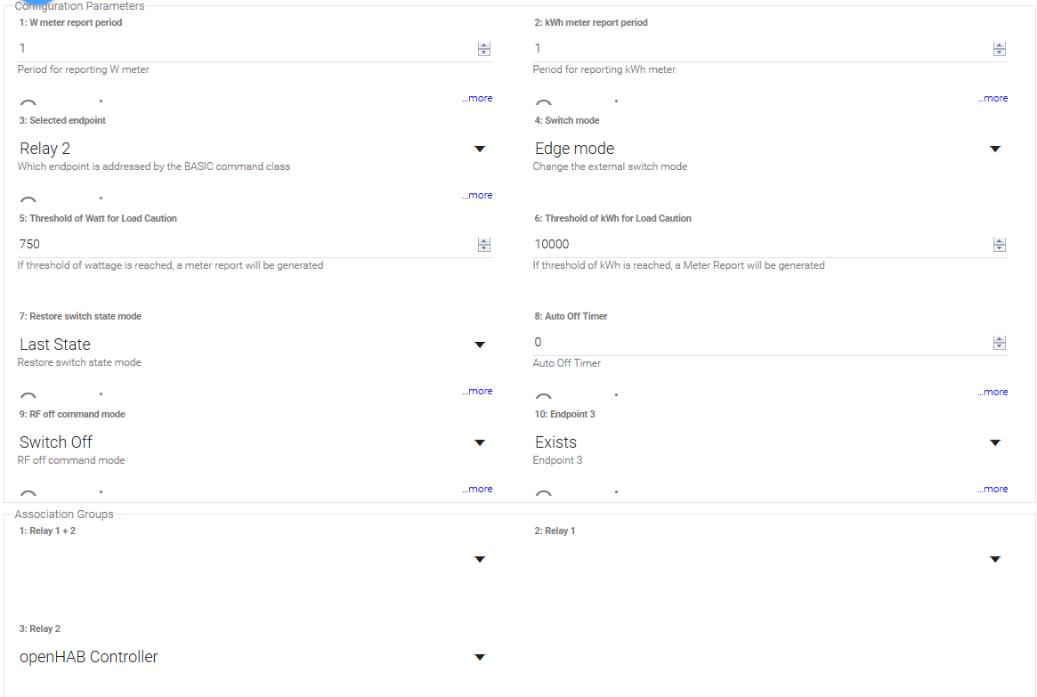

Hi, I’m trying to synchronize all lamps in the room with Wall Switch (turning all lights by one button). Everything works fine when I turn ON/OFF light from Paper UI Control Screen, however when I use physical button main light turn on immediately but there is no state change in OpenHAB so rule cannot be executed. It tooks several minutes to change the state in OpenHAB and trigger the rule.

However, the PAN04 is a bit tricky. Essentially, it can send you updates about one of the switches only. You decide: either one, or the other, but not both. The “both” specified on the documentation essentially does not work, because it will not tell which of the switches was touched.

In practice - this seems to be a good news. I need to associate all lamps with only one switch (second is less important).
So could you tell me two things:
If I change configuration to only one switch (let’s call it Switch 2) would OpenHAB get slow updates from Switch 1 (as it’s right now - I assume during the pooling but I could be wrong)
Which parameters needs to be changed to apply the change?
I face the problem with persistence of Relay 2 Association Group - I’m setting up openHAB controller but after re-opening of openHAB Paper UI the field is empty. Is this a way how it suppose to work?
Currently the time between physical button switch and change is openHAB is 5 min. Is this minimal time or should be much shorter?
