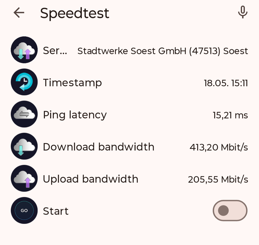

Sorry, but still works fine on 5.2.0.M4 :
