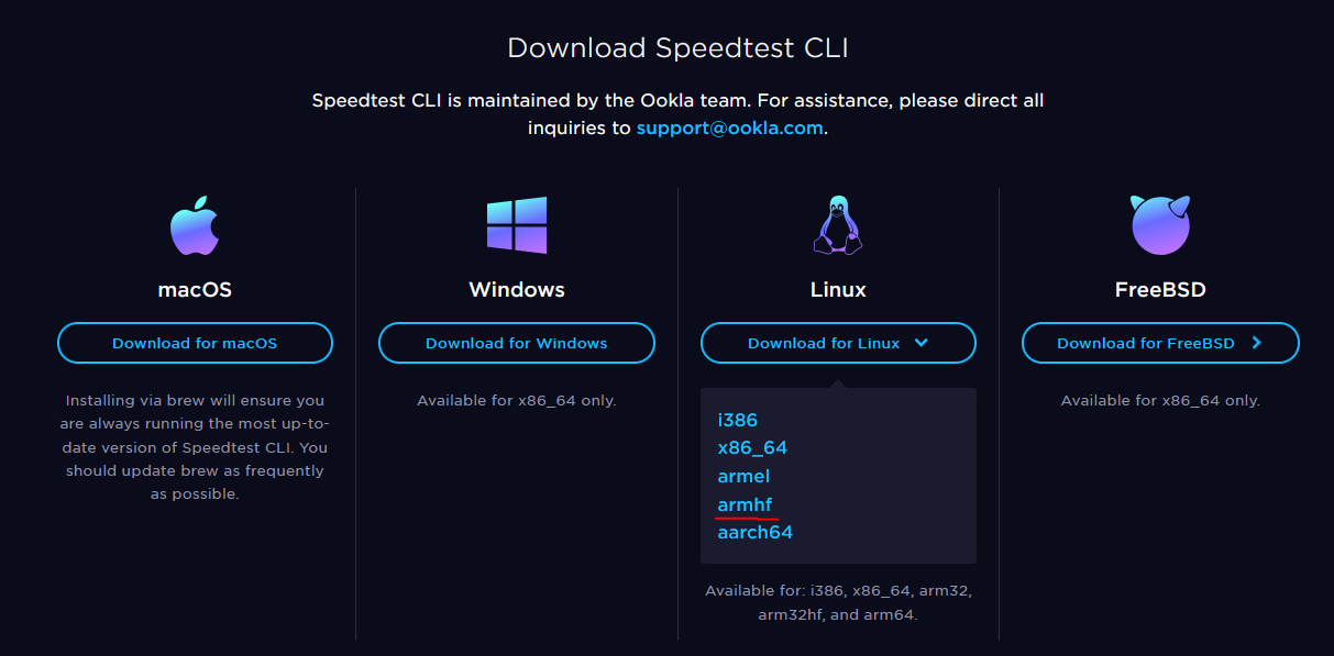

On that page: Speedtest CLI: Internet speed test for the command line you can download executable for speedtest.
(for RPI: https://install.speedtest.net/app/cli/ookla-speedtest-1.0.0-armhf-linux.tgz)

Then try to do what is in the last line of your code :slight_smile:
It will be this file probably:
https://install.speedtest.net/app/cli/ookla-speedtest-1.1.1-linux-x86_64.tgz

Hi
thx. I am not an expert. I run openhabian on a RasPi4. I have no idea where to put these files then and what to do. If I got it right, you suggest there “armhf” config. OK. I have downloaded the files to my Mac. I can put it to my Rapsi…where? And what next?
