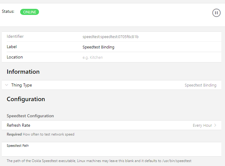

Very simple to configure :

Under a linux based system it will default to /usr/bin/speedtest for the executable location, so there shouldn’t be much to configure other than how often you want to get the data.

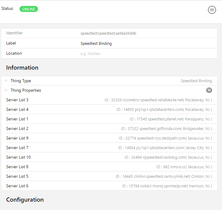

I’ve updated the binding to include the ability to select a server ID to test with. I couldn’t come up with a great way to display your options, so here is what I came up with.
Configure it as normal(auto detect) and on the first run it will check the list of closest servers. When that is done, it will fill it in the binding properties :
Just copy/paste one of those ID’s into the new field below it “Server ID”. If you want to put it back to defaults, just remove that setting.
I know they are not ordered correctly, and I have no idea why. It seems to be arbitrarily determine that somehow, but I couldn’t figure that out, I tried. Server List 1 is considered the closest by Ookla standards and it goes on from there.
And I know it’s sort of a hack to do it that way, but it was really the best I could come up with. I was going to put the list in a channel so you could just view it from the Model view, but OH doesn’t allow line feeds or carriage returns in the channel data for a label.
