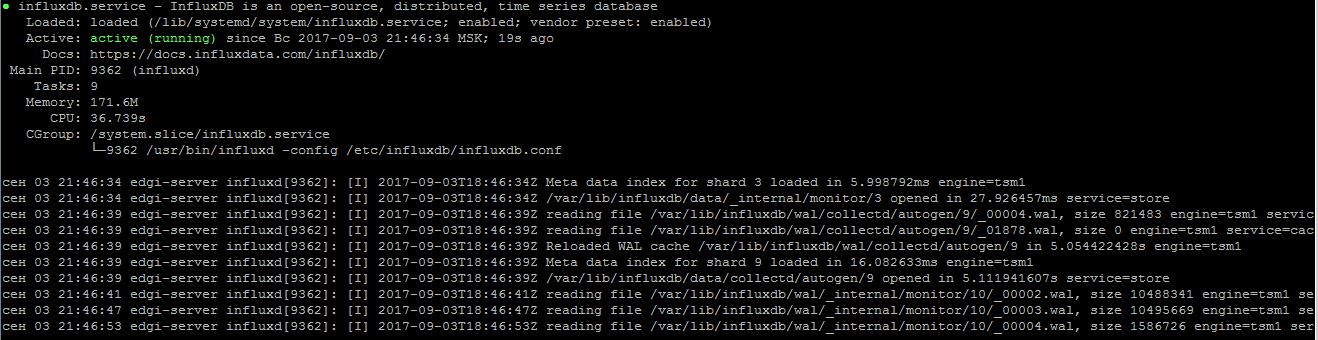

5. sudo systemctl status influxdb:
Снимок2
No data db openhab:
root@edgi-server:/etc/openhab2/items# influx
Connected to http://localhost:8086 version 1.4.0~n201709010800
InfluxDB shell version: 1.4.0~n201709010800
> auth
username: openhab
password:
> use openhab
Using database openhab
> show measurements
nothing no data from openhab
