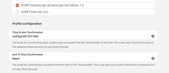

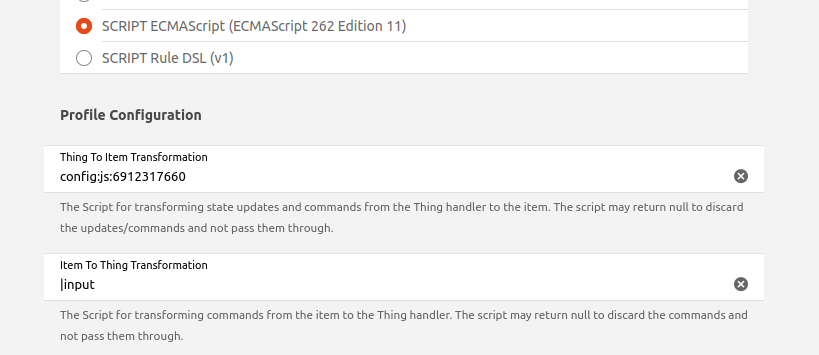

So how can I use a script inside a things definition replacing the transformationPattern= code?
There is a profile section under the thing then the item that is linked to the thing:
Then under settings>transformations you create the transformation code:
Screenshot from 2024-06-23 21-22-13
And the code is something like this:
//this checks the code of fronius errors
(function(i) {
var val = parseFloat(i);
if (val == 567 || val === 0 )
{ return val; }
})(input);
I am using OH4.1.3 and only use the UI. If you are using files then I don’t know how to do it that way.
Basically you add the transform using the script IDin this case config:js:6912317660
If you click the field it tells you the the code name.
