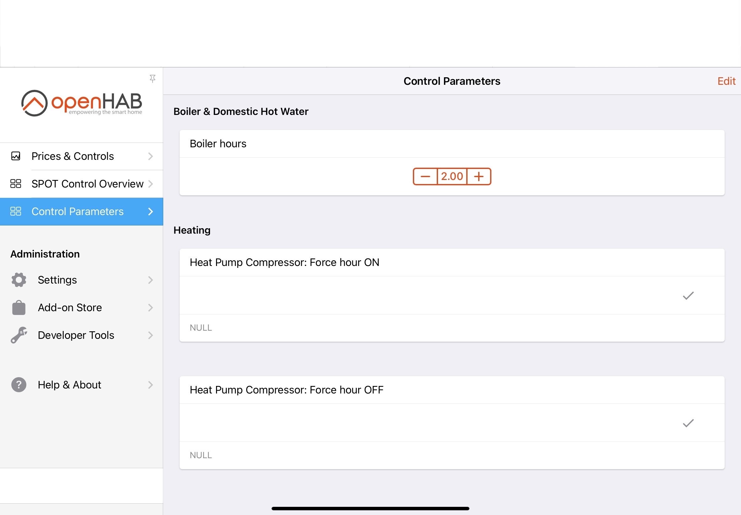

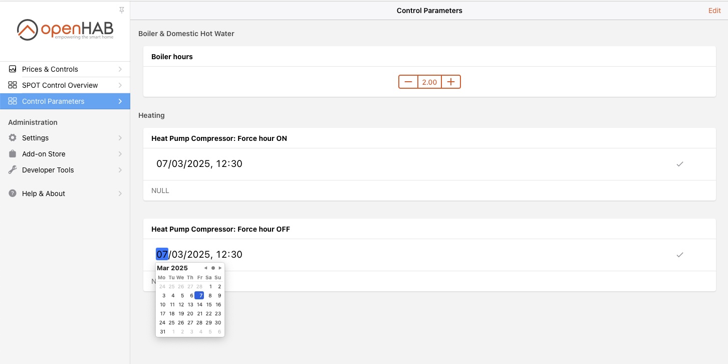

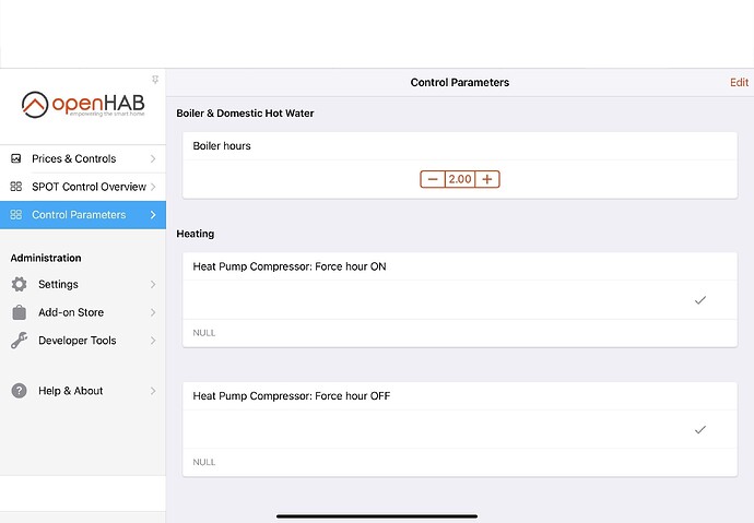

There also seems to be some kind of problem (OS related?) with the datetime selector in the Control Parameters page,
  • on an iMac OSX in Safari it is shown but not working
  • on an iMac running Windows 11 in Paralells Desktop in both Firefox and Edge it is shown in two different selection layouts (have not tested working though)
  • on an iPad IOS in both Safari and Chrome the selector is not shown at all
Is there any solution for this?

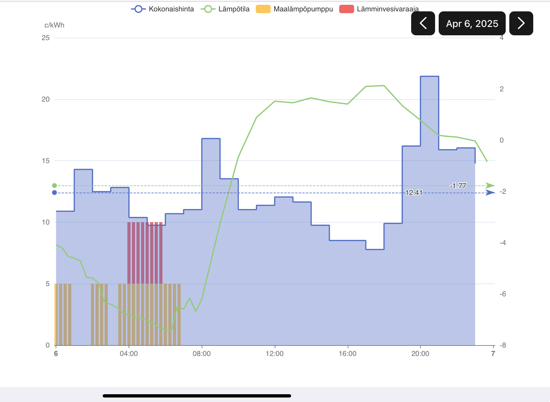

I just rerun the heat pump optimizing for tomorrow,
  • settings 1 heating period for the hole day gives a total heating time of 4,5 hours divided in two periods 0:00 to 3:00 and 22:30 to 0:00
  • settings 1 heating period between 0:00 and 8:00 gives a total heating period of 2 hours between 0:00 and 2:00
A total of 4,5 hours seems to be correct, our old system has 4 hours for tomorrow between 0:00 and 4:00.
Forcing the hours to start at 0:00 and stop at 8:00 doesn’t allocate the total 4,5 hours needed beween these times.

By the way, any ideas why the datetime selector doesn’t show up on IOS devices?
No, unfortunately not. See my comment 2 days ago how I would propose to proceed with that.
The code for the Control Parameters page is here just as copy pasted from your Github page.

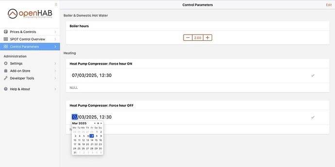

When run on an iMac Mini the page looks like this but the date time control doesn’t work, item setting doesn’t get set.
And when viewed on an iPad the date time picker is not shown at all.
As I mentioned earlier, this looks like an openHAB core issue, not related to the openHAB Spot Price Optimizer.
I have no idea whatsoever how the date picker is implemented under tje hood. You are (much) more likely to get support to this date picker issue if you create a completely new thread to the forum which is specific to the datepicker thing.
Markus
After the latest IOS update the DateTime picker is now shown with the time selection shown in the Apple scrolling style and it is setting the ForceOn/Off item state.

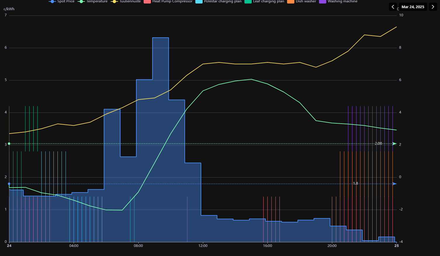

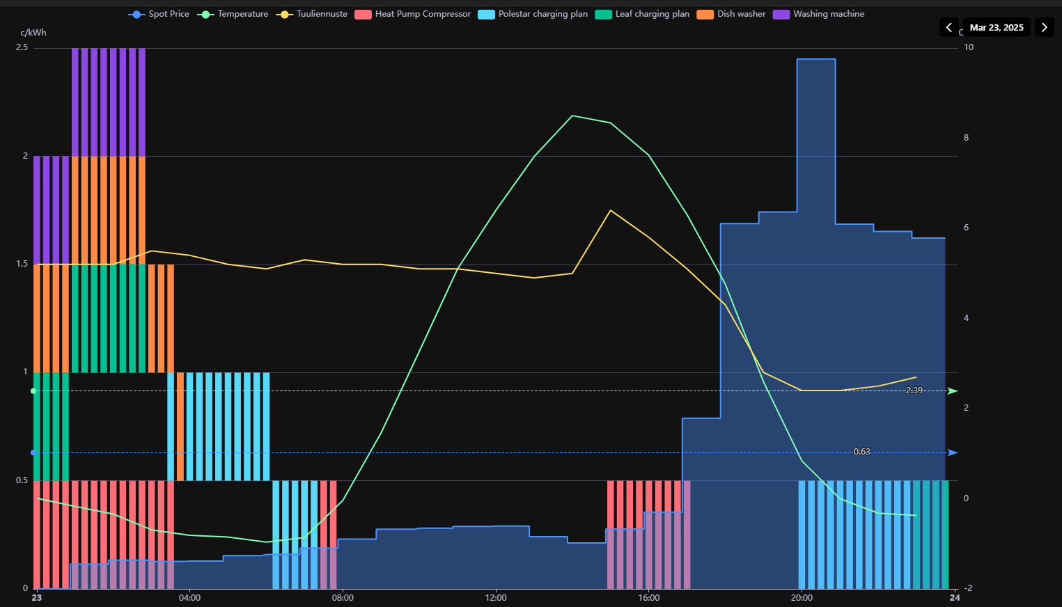

I am using version 3 of the spot price oprimizer. For some reason the graph for current day shows the bars as very thin lines. In addition the stack has a “ghost member” that shows up as a fully transparent bar, that I can not identify.
Graph for today:
Graph for previous days is always ok, except for the “ghost bar” that can be seen in the wee hours of the morning . Here is the graph for yesterday:
I have removed and rewritten all graph YAMLs to no avail. Any ideas where to continue debugging?

This means that there are control points in your database with lesser resolution than 15 minutes.The first thing is to try pinpoint if this is happening to all of your items (heat pump compressor, polestart charging, leaf charging, dish washer, washing machine) or just one of them.
So try to toggle down all these control points in your graph (don’t modify the code, click the legend to hide it temporarily). Then enable the items one by one to see if you get the “normal” thicker bars (that happens when you have data with 15 min resolution) or if you get thinner bars (that happens when you have at least 1 control point which is between the normal control points that you have at 00, 15, 30 and 45 min past a full hour. You can either move your mouse carefully over the graph to see the timestamps for the control points that you have, or you can write a temporary small script that prints all control points to the log.
Once you identify which item is causing the narrow bars, you need to start thinking that what else than the optimzer rules could be persisting data to those items. It can be for example that you have define the persistence strategy to be like “on every change” or “on every update”, and that you have some other stuff that you have built for UI purposes that is writing data to your database.
Markus

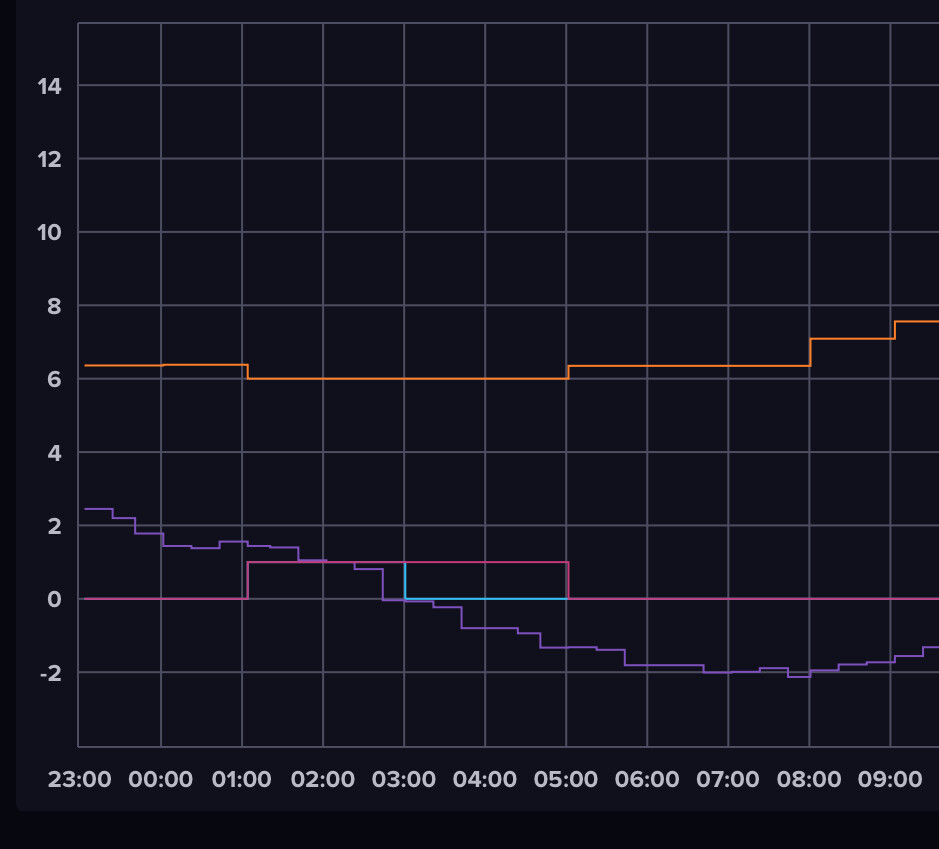

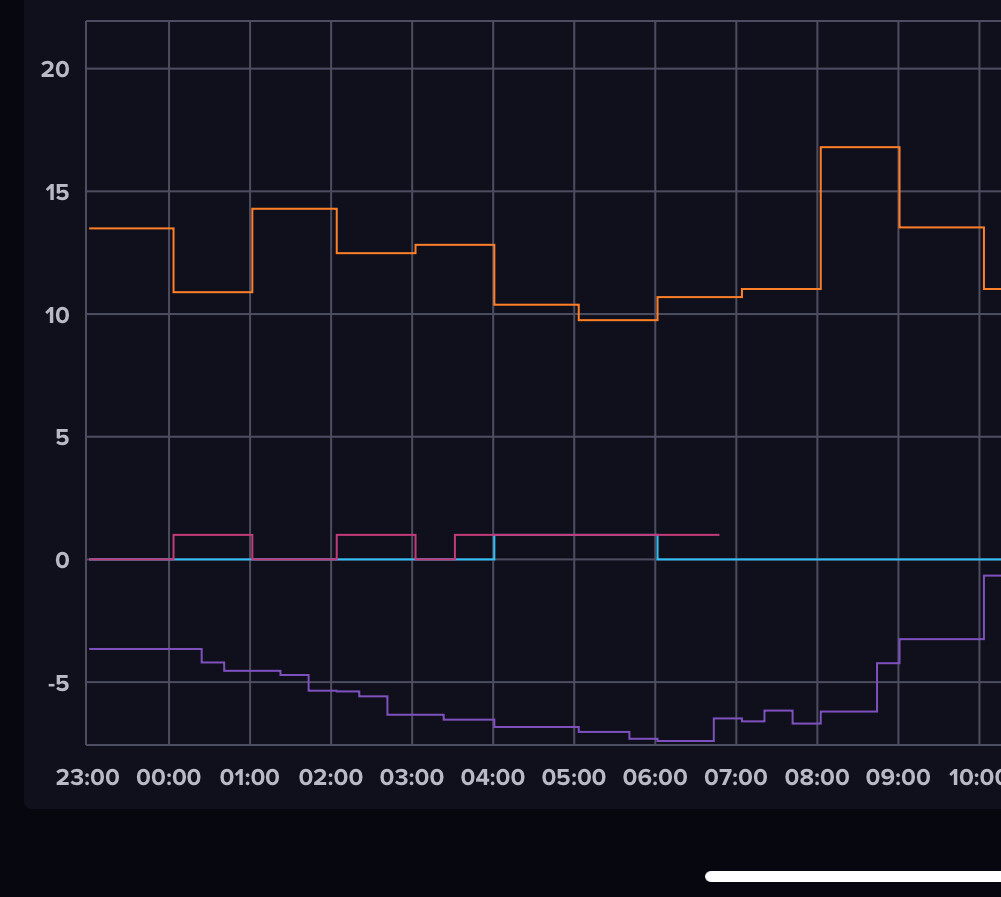

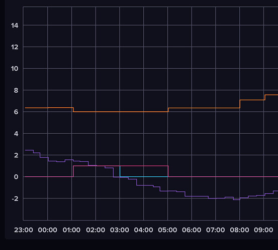

A small problem occured in the system last night - the heat pump did not stop at the end of the heating period. In our setup the time window for the optimization is between 22.00 and 7.00. If the heat pump is optimized to run for example between 1.00 and 3.00 everything works fine but if the run hours are like last night 3.30 and 7.00 the heat pump does not stop at 7.00 that also is the optimization window end.
The chart in openHAB looks OK but if you look at the InfluxDB chart you can see that there are no 0 values after 7.00. In a chart where the heating period stops before 7.00 there are correct values for the whole day. The red Influx curve is the heat pump.
Last night charts - heating doesn’t stop at 7.00
Previous night OK
The code optimizing the heat pump is based on your earlier suggestions.

Bye the way, the same problem also occures with the boiler if the heating period ends at the optimizing window time. Any ideas how to fix this issue?
Create another rule action / modify your existing rule which blocks everything between 07 and 22.
You can do this using GenericOptimizer, using 07-22 as the window and using the blockAllRemaining method.
This will guarantee that you have control points 1 or 0 for the whole day. First created by your existing rule and the rest by this “block all” rule.
Markus
Thx once again Markus. Modified the rule according to your suggestions and temporarely modified the end and start times to re-run last nights optimization. Now the InfluxDB got 0 values for the 7.00 to 22.00 time window.
Rainer
Hi
Super nice work as before, I updated to the newest relaease today and have openHab 4.3.4 with Entsoe-E binding and FMI binding installed and configured. I get data in influx db from them but whe i try to execute generic optimizer I get the following error measseages. 1 is the amount of hours to be active between the two following timestamps, that is set by an item. As far as I understand the generic-optimizer.js this error comes when you have les than two points in the spotprice item, however I have data for today and tomorrow. Doesn anyone have any idea what could have been going wrong?
16:47:59.794 [INFO ] [enhab.automation.script.ui.df884217b9] - 1
16:47:59.800 [INFO ] [enhab.automation.script.ui.df884217b9] - 2025-04-14T12:37:32.302+02:00[Europe/Stockholm]
16:47:59.806 [INFO ] [enhab.automation.script.ui.df884217b9] - 2025-04-14T20:47:59.801+02:00[Europe/Stockholm]
16:47:59.914 [ERROR] [enhab.automation.script.ui.df884217b9] - generic-optimizer.js: Not enough prices for optimizations!
16:47:59.915 [ERROR] [enhab.automation.script.ui.df884217b9] - generic-optimizer.js: Aborting optimization, see previous errors!
16:47:59.916 [INFO ] [enhab.automation.script.ui.df884217b9] - generic-optimizer.js: block all remaining...
16:47:59.916 [ERROR] [enhab.automation.script.ui.df884217b9] - generic-optimizer.js: Aborting optimization, see previous errors!
16:47:59.917 [ERROR] [enhab.automation.script.ui.df884217b9] - generic-optimizer.js: Aborting optimization, see previous errors!
Part of rule that have been edited to get start and possible end time from item.
// Read how many hours are needed from the BoilerHours item.
var item = items.getItem('EV2_estimated_charging');
var hours = parseFloat(item.numericState);
console.log(hours)
// Define the optimization window here, this example optimizes tomorrow.
var startItem = items.getItem("Evconnected");
var start = time.toZDT(startItem);
console.log(start);
var end = time.toZDT().plusHours(4);
