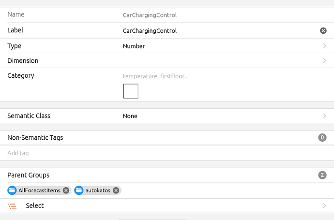

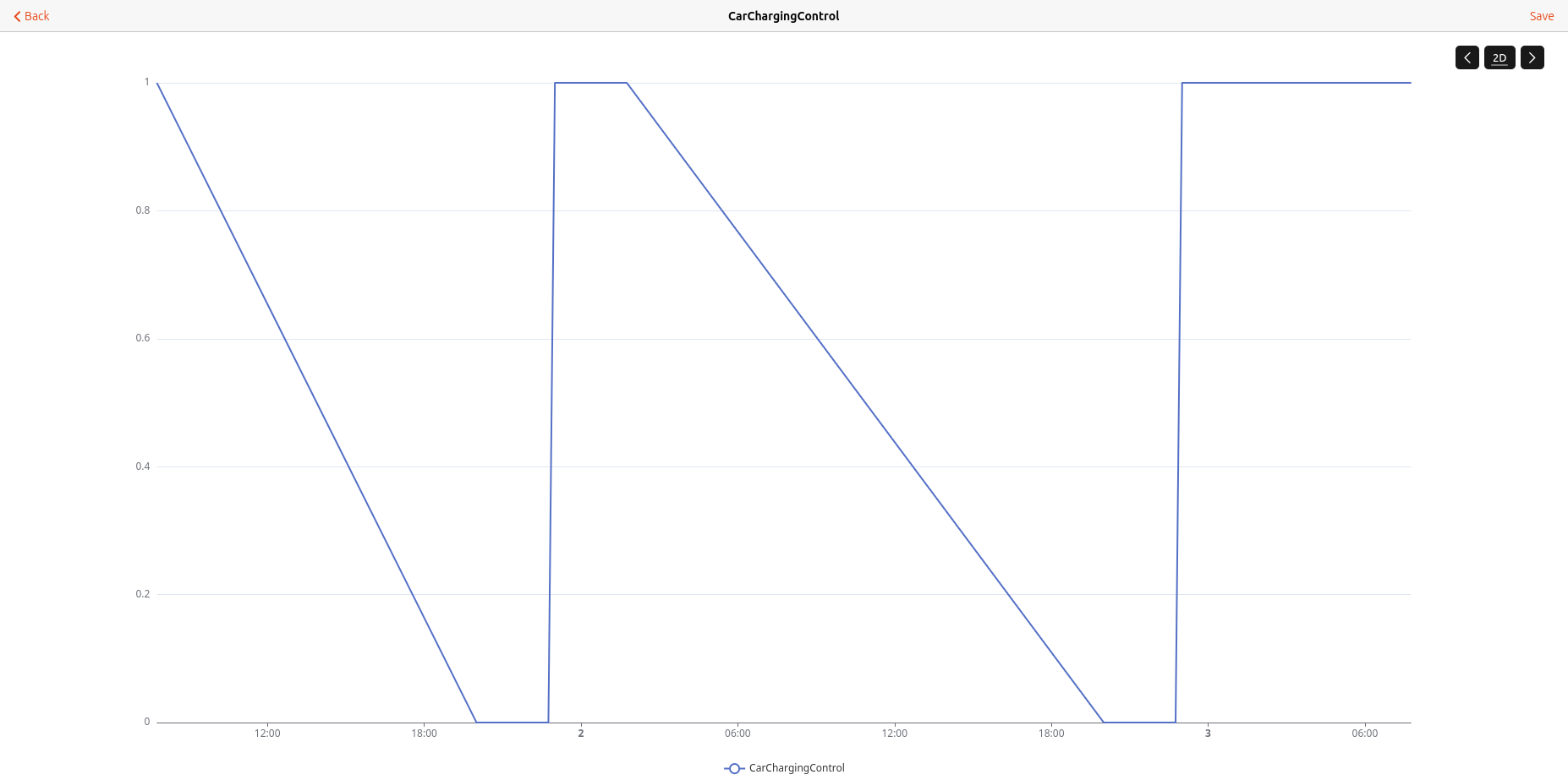

I have been commissioning Version 4 for a couple of weeks time permitting. Most features work again, but I have trouble with the car charging scripts I cannot solve. Seems like the “Block all remaining” only blocks within the optimizing window and leaves the rest of the control points in an undefined state, that Openhab for some reason interprets as state 1. This results in the charger being on during these undefined states, too. Updated to OH 4.3.5 in hopes it would solve the problem, but no.
Here is a plot of the control item CarChargingControl that illustrates the problem:

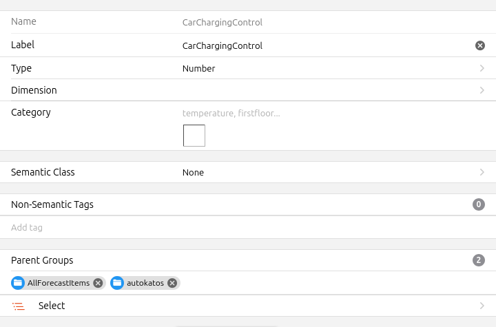

CarChargingControl item:
CarChargingOptimizer script:

My script doesn’t behave that way, could it be your failsafe else statement in the end that confuses things. How will the script perform without that?

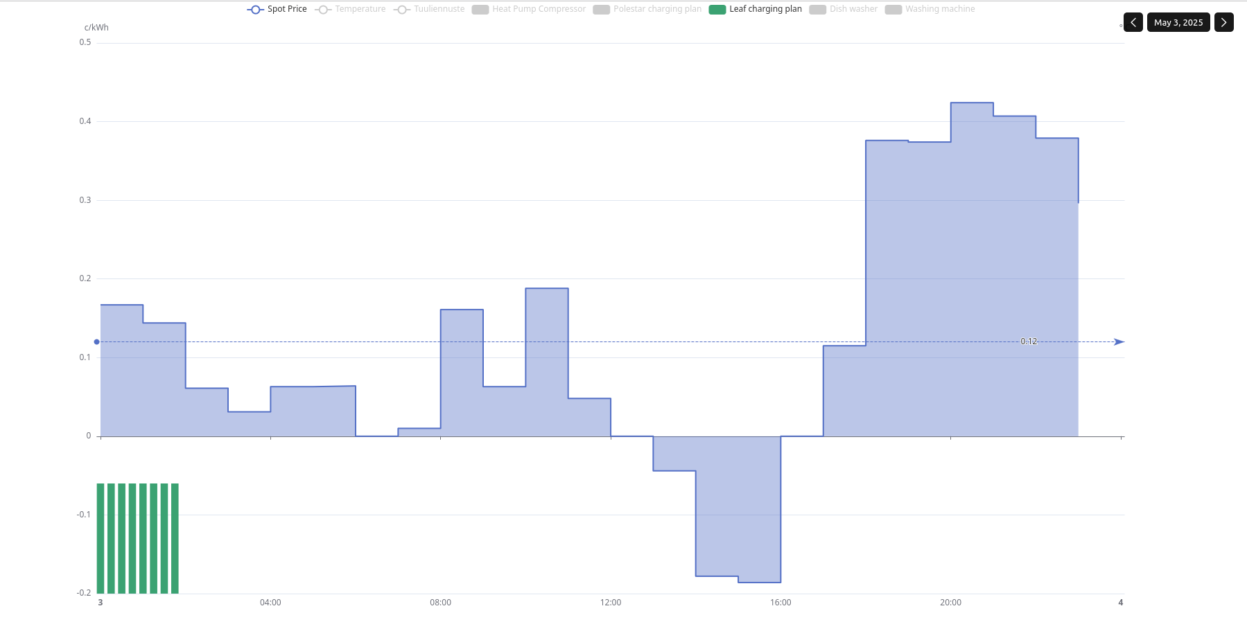

Thank you for the feedback. I did some further twinkering during the weekend and the script below seems to work as it should. In short, I separated the spot price time interval from the optimisation interval. I commented out the lines that I have changed, so it should be fairly easy to see how I did it.
// Load module and create service.
var { GenericOptimizer } = require('openhab-spot-price-optimizer/generic-optimizer.js');
var optimizer = new GenericOptimizer();
// Define price item and control item here.
var priceItem = items.getItem('SpotPrice');
var controlItem = items.getItem('CarChargingControl');
// Read how many hours are needed from the CarChargingHours item.
var item = items.getItem("CarChargingHours");
var hours = parseFloat(item.numericState);
//NEW 4.5.2025 define total spotprice data length
var spotstart = time.toZDT('00:00');
var spotend = spotstart.plusDays(2);
// Define the optimization window here,
var start = time.toZDT('20:00');
var end = time.toZDT('04:00').plusDays(1);
// Define the delay (seconds) to ensure prices have been saved first.
var delay = 60;
// Read prices from the database, optimize and save the control points.
var delayedFunction = function() {
// var prices = priceItem.persistence.getAllStatesBetween(start, end); // Commented out 4.5.2025
  var prices = priceItem.persistence.getAllStatesBetween(spotstart, spotend); // New 4.5.2025
  optimizer.setPrices(prices);
  optimizer.allowPeriod(hours, start, end); // New 4.5.2025
//  optimizer.allowPeriod(hours); //Commented out 4.5.2025
  optimizer.blockAllRemaining();
  var timeseries = optimizer.getControlPoints();
  controlItem.persistence.persist(timeseries);
// Create a timer that calls delayedFucntion after the delay.
actions.ScriptExecution.createTimer(time.toZDT().plusSeconds(delay), delayedFunction);
