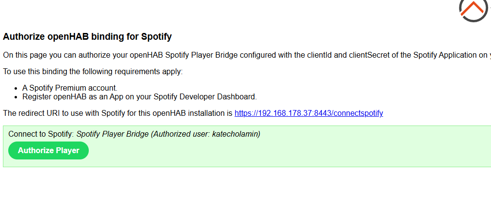

Hi, what worked for me (running my openhab at 192.168.178.37):
Thanks.
Have added in the https in addition to the http in the Spotify developer and now it will authorise - Even though the https address does not work!! [obviously used my IP and not yours :slight_smile: ]
