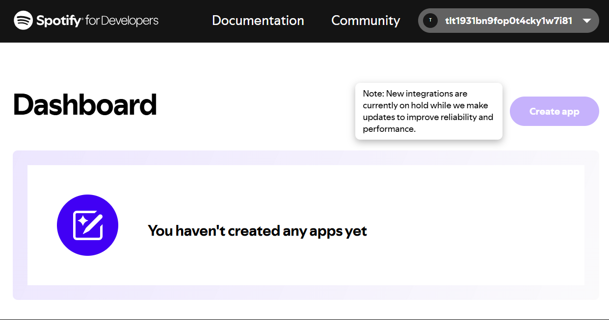

I tried to authorize openhab with spotify but get the following message:
My question when it will again be possible to authorise, I get the following answer from Spotify support (German translated into English):
We in customer support don't have precise information on this, but as things stand, the feature won't be available again and will remain as it is for the time being. We welcome your feedback so we can forward it to the appropriate team. You can start a discussion and share your thoughts in our community: https://community.spotify.com/.
Existing apps (registered before the change) will continue to work with openHAB, but new apps cannot be created. The only solution is to find someone with an existing app (e.g., from the openHAB community forums) who is willing to temporarily share their Client ID/Secret and then enter it into your openHAB Spotify Bridge configuration at http://your-openhab:8080/connectspotify.

Spotify has re-open the new API registrations as of yesterday. The button above should now be active.
Thank you @Pawel_Wrona it worked for me!
