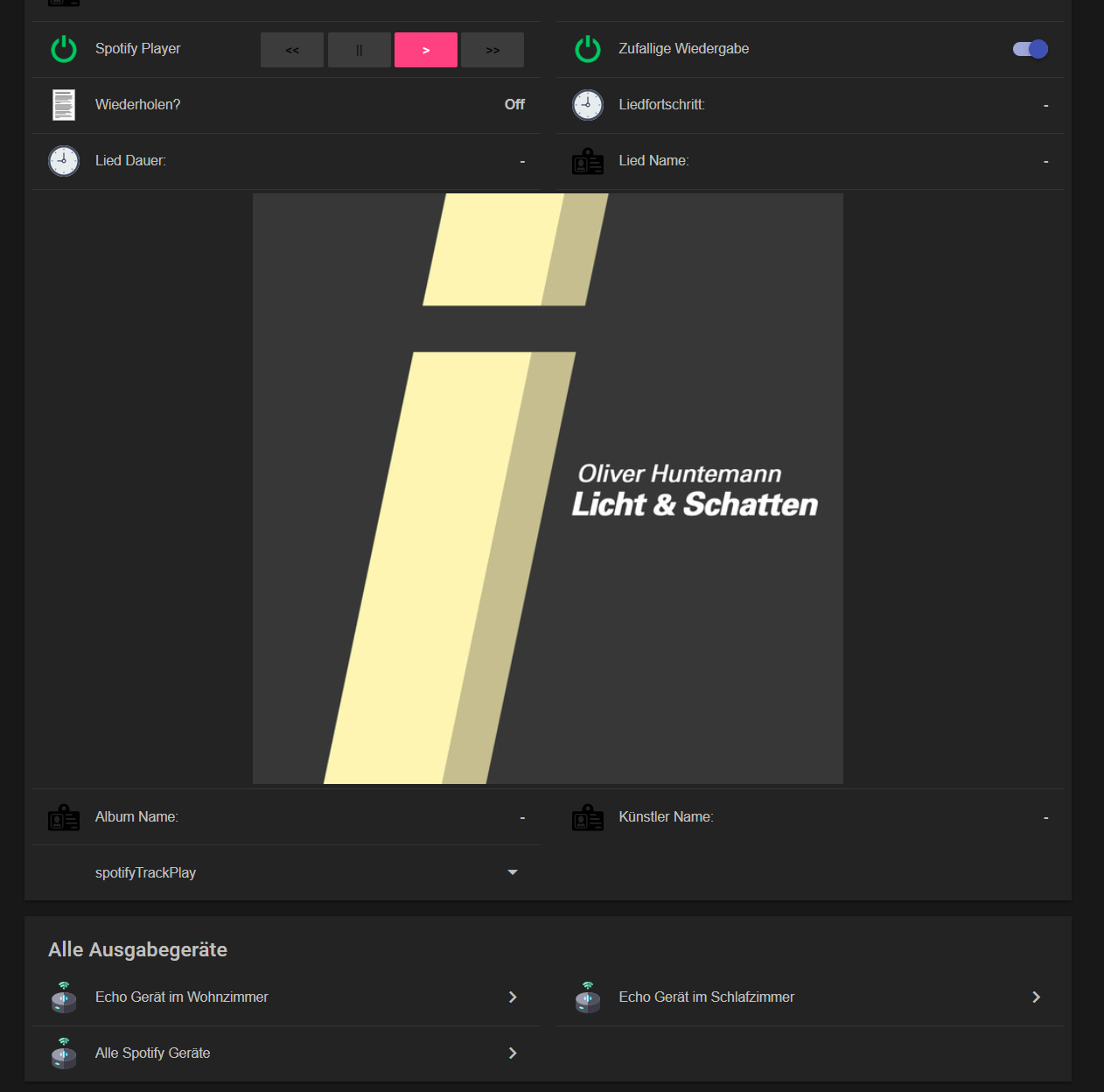

Hey @hilbrand,
I’m not sure if I stumbled upon a bug or it’s a user error>
While most API-calls work just fine, including cover art and Progress I’ve found a few which are simply never populated:
  • trackDurationMs
  • trackDuration
  • trackNumber
All others which I tested work just fine and update live (e.g. trackProgress, album cover, names, etc).
The only pattern for them I’ve noticed is that all of those have an underscore in the spotify API (track_number, duration_ms, etc). Not sure if that helps though.
The (working, except those three) configuration is:
Player spotifyDevicePlayer	"Player"	{channel="spotify:player:user1:devicePlayer"}
String spotifyDevices       "Active device [%s]"   {channel="spotify:player:user1:devices"}
Player spotifyTrackPlayer   "Player"               {channel="spotify:player:user1:trackPlayer"}
Switch spotifyDeviceShuffle "Shuffle mode"         {channel="spotify:player:user1:deviceShuffle"}
String spotifyTrackRepeat   "Repeat mode: [%s]"    {channel="spotify:player:user1:trackRepeat"}
String spotifyTrackProgressMs "Track progress: [%s]" {channel="spotify:player:user1:trackProgressMs"}
String spotifyTrackProgress "Track progress: [%s]" {channel="spotify:player:user1:trackProgress"}
String spotifyTrackDuration "Track duration: [%s]" {channel="spotify:player:user1:tackDuration"}
String spotifyTrackName     "Track Name: [%s]"     {channel="spotify:player:user1:trackName"}
String spotifyAlbumName     "Album Name: [%s]"     {channel="spotify:player:user1:albumName"}
String spotifyArtistName    "Artist Name: [%s]"    {channel="spotify:player:user1:artistName"}
Image  spotifyAlbumImage    "Album Art"            {channel="spotify:player:user1:albumImage"}
String playlists            "Playlists [%s]"       {channel="spotify:player:user1:playlists"}
Thanks again for the work! Let me know if I can do something to get more information (or if I made a mistake)
Cheers!
(edit> fixed the file)
Hey!
Does anyone else receive this bug?
Channels, item names and everything else are good. Item linking was enabled when creating all items.
The items from my sitemap arent linked properly to the item definitions ..
PS:
It was the item linking, delteded and recreated the bridge and it works fine.
