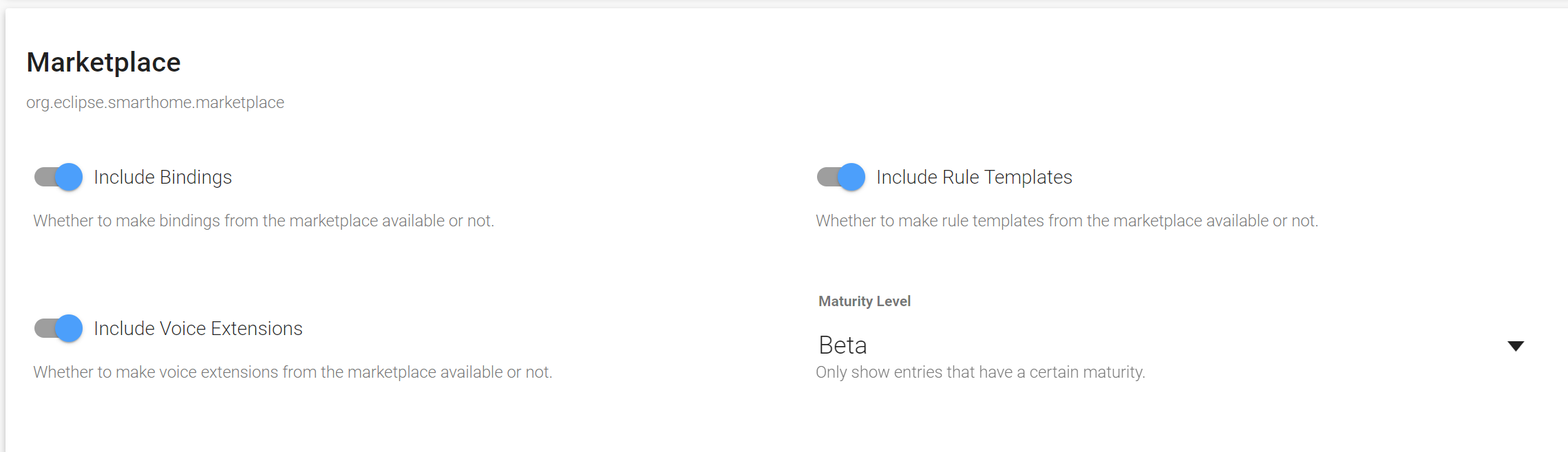

hi @hilbrand i use openhabian 2.4.0-1 release build and just did an update/upgrade. Could you please tell me where to find the Eclipse Market place in paper ui? in configuration system there is no Eclipse Mareket place, where exactly do i have to look?

Hi, does anyone know how to access Eclipse market to authorize it with maturity level beta? Where exactly do I have to look? In paper ui/systems I couldn’t see it!

Configuration - System - MarketPlace
Thank you for your replay man. The problem is that I don’t have this market place in: paper ui / system! Do I have to download something in order to get this market place in papaer ui? I have openHABian 2.4.0 with the latest update/upgrade.
Thanks again.
Marketplace is an add-on that needs to be installed, it’s under misc
