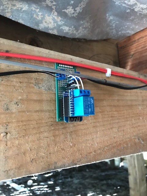

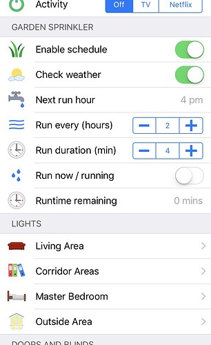

I’ve built a garden sprinkler system with Wemos and relay, attached to a solenoid, using MQTT to/from OpenHAB to control. It works well, however I’m using a fairly basic number format for the “Next run hour”. Instead, I want the “Next run hour” to appear in a friendly format rather than just a number.

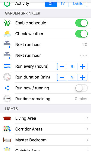

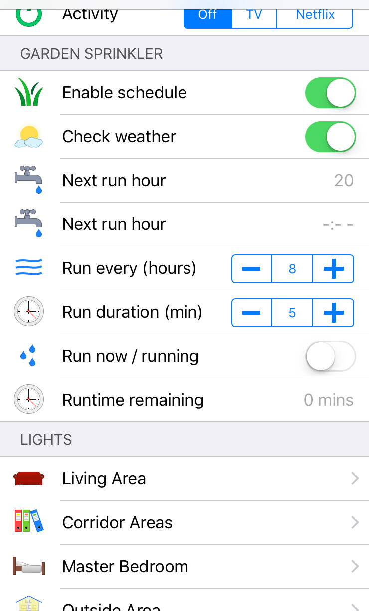

As per screenshot below, you can see the “Next run hour” is just a Number in 24 hour format, not that user friendly. I want to convert to, for example, “Next run hour = 5:00PM” I’ve read the datetime (joda) vs datetimetype (java) - and the screeds of confusion between them, yet have had a heap of log errors on type conversions etc, while trying to work out how to do using a DateTime item.
(Note: I haven’t done the “Check Weather” portion yet, that will simply check weather binding if its raining, and not run if it is)
The items file as follows (the 2nd “Next run hour” is what I want to move too)

So, should I persist with using only a DateTime item for the RunNext hour, or should I use a String item instead and format it myself, or should I use sprinklerNextHour simply as a hidden proxy item and utilise the other item to format the user friendly date time view?
What would be the easiest method here? Any suggestions appreciated.

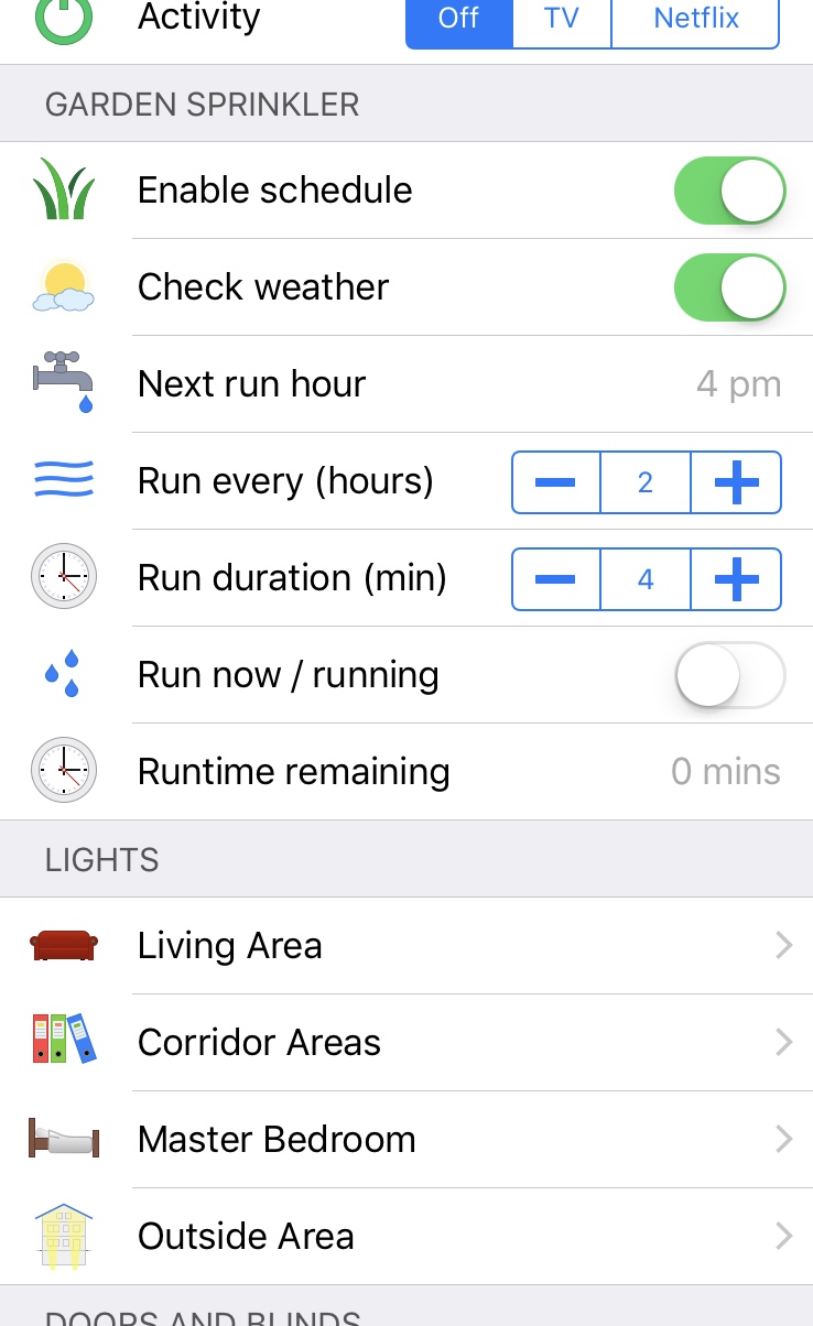

Now the GUI appears much more user friendly!
Any suggestion for improvement please let me know…

Below is full Arduino code if you’re interested…

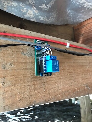

Some further information for anyone’s info…
Excluding plumbing and fittings to run pipe out to the garden plus a couple of taps that I bought locally, this setup cost me under US$13…
Wemos D1 mini = US$2.95
Wemos relay shield = US$0.75
12V solenoid valve = US$3.07
20pcs Garden Irrigation = US$6.01
Circuit board, voltage regulator and capacitors already had, but probably US$0.50 worth
I had a 12V wall wart lying around already.

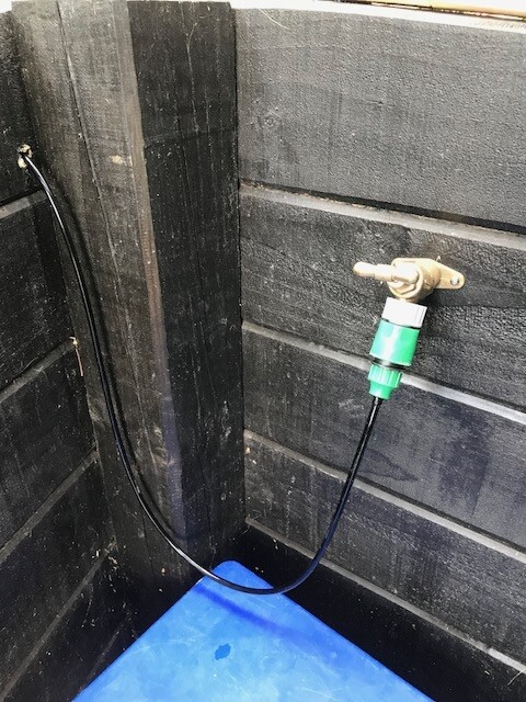

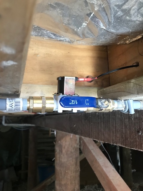

Some setup images…
Solenoid with tap prior, incase solenoid dies and needs replacing…
Wemos and relay shield, not quite mounted properly yet :slight_smile: Solenoid requires 12V power to open (solenoid and wemos powered by same power supply - otherwise if powered separate and Wemos lost power while sprinkler was running, then water could stay on until fixed!)

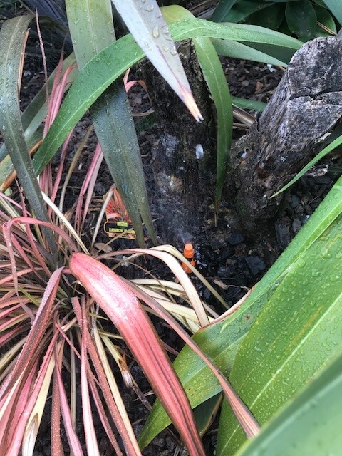

Plumbing runs behind my retainer wall, to another garden tap then off to garden irrigation
About 8 x mini garden sprinklers hang off the irrigation

Sitemap (I renamed ‘sprinklerNextHour’ to ‘sprinkerNextRuntime’ as it was more logical) and added in rain forecast at the bottom
			Frame label="Garden Sprinkler"
				Switch item=sprinklerSwitch
				Switch item=sprinklerIncludeWeather
				Text item=sprinklerNextRuntime {
					Frame {
						Switch item=sprinkler_Period label="Period" mappings=[0="Day", 1="Week", 2="Month"]
						Image url="http://localhost:8080/rrdchart.png?items=sprinklerRunNow&period=D" visibility=[sprinkler_Period==0, sprinkler_Period==Uninitialized]
						Image url="http://localhost:8080/rrdchart.png?items=sprinklerRunNow&period=W" visibility=[sprinkler_Period==1]
						Image url="http://localhost:8080/rrdchart.png?items=sprinklerRunNow&period=M" visibility=[sprinkler_Period==2]
				Setpoint item=sprinklerRunEvery minValue=1 maxValue=24 step=1
				Setpoint item=sprinklerDuration minValue=1 maxValue=30 step=1
				Switch item=sprinklerRunNow
				Text item=sprinklerRuntime
				Text item=Weather_Rain

					publish("mqttbroker", "openhab/sprinkler/duration", sprinklerDuration.state.toString)
					publish("mqttbroker", "openhab/sprinkler/trigger", "START")
					logInfo("sprinkler", "Sprinkler next start hour " + sprinklerNextRuntime.state.toString)
rule "Sprinkler runtime complete"
	Item sprinklerRuntime changed
	if (swSystemBootUp.state == OFF)
		if (sprinklerRuntime.state == NULL || sprinklerRuntime.state == 0)
			logInfo("Sprinkler", "Sprinkler run cycle complete or cancelled")
			boolSprinklerRunning = false
			sendCommand(sprinklerRunNow, OFF)
rule "Sprinkler run every hours changed"
	Item sprinklerRunEvery changed
	var RunEvery = sprinklerRunEvery.state as Number
	var DateTime RunNext = now.plusHours(RunEvery.intValue)
	sendCommand(sprinklerNextRuntime, DateTimeType.valueOf(RunNext.toString))
rule "Sprinkler Proxy turned on / off, for Alexa control"
	Item sprinklerProxyOnOff changed
	if (swSystemBootUp.state == OFF && sprinklerProxyOnOff.state !== null)
		// Proxy item changed, turn sprinkler on or off
		if (sprinklerProxyOnOff.state == ON)
			logInfo("Sprinkler", "Received request to turn sprinkler system ON")
			sendCommand(sprinklerRunNow, ON)
		else
			logInfo("Sprinkler", "Received request to turn sprinkler system OFF")
rule "Keep sprinkler on/off and proxy item in sync"
	Item sprinklerRunNow changed
	if (swSystemBootUp.state == OFF && sprinklerRunNow.state !== null)
		if (sprinklerRunNow.state == ON)
			sendCommand(sprinklerProxyOnOff, ON)
		else
			sendCommand(sprinklerProxyOnOff, OFF)
Items (“sprinkler system” is switchable because I use with Alexa to turn on via voice command)
/* Sprinkler System */
Group           gSprinkler    				                                                               (gHouse)
Number          sprinklerState                   "Sprinkler [MAP(status.map):%s]"	     <settings>        (gSprinkler)                               { mqtt="<[mqttbroker:openhab/sprinkler/status:state:default]" }
String          sprinklerIPAddress               "Sprinkler IP [%s]"                     <network>         (gSprinkler)                               { mqtt="<[mqttbroker:openhab/sprinkler/ipaddress:state:default]" }
DateTime   		sprinklerNextRuntime       		 "Next run time [%1$tl %1$tp]"           <faucet>          (gSprinkler)
Switch          sprinklerSwitch                  "Enable schedule"                       <lawnmower>       (gSprinkler)
Switch			sprinklerIncludeWeather			 "Check weather"						 <sun_clouds>      (gSprinkler)
Switch          sprinklerRunNow                  "Run now / running"                     <water>           (gSprinkler)                               { mqtt=">[mqttbroker:openhab/sprinkler/trigger:command:ON:START], >[mqttbroker:openhab/sprinkler/trigger:command:OFF:STOP], <[mqttbroker:openhab/sprinkler/trigger:state:ON:START], <[mqttbroker:openhab/sprinkler/trigger:state:OFF:STOP]" }
Switch          sprinklerProxySwitch             "Not run, rescheduled"                  <water>           (gSprinkler)
Number          sprinklerRuntime                 "Runtime remaining [%.0f mins]"         <time>                                                       { mqtt="<[mqttbroker:openhab/sprinkler/runtime:state:default]" }
Number          sprinklerRunEvery                "Run every (hours) [%.0f]"              <flow>            (gSprinkler)
Number          sprinklerDuration                "Run duration (min) [%.0f]"             <time>            (gSprinkler)                               { mqtt=">[mqttbroker:openhab/sprinkler/duration:command:*:${command}]" }
Switch          sprinklerProxyOnOff              "Sprinkler system"                                                           ["Switchable"]
Number 			sprinkler_Period				 "Chart Period"                                            (gSettings)
Number 			sprinkler_RainThreshold		     "Rain threshold"                        <sewerage>        (gSprinkler)
Number   		Weather_Rain          			 "Rain forecast [%.2f mm/h]"             <rain>            (gWeather)                                 { channel="openweathermap:weather-and-forecast:1cb13ebf:local:forecastHours06#rain" }
Sitemap
					Frame {
						Image url="http://localhost:8080/rrdchart.png?items=sprinklerRunNow,sprinklerProxySwitch&period=D" visibility=[sprinkler_Period==0, sprinkler_Period==Uninitialized]
						Image url="http://localhost:8080/rrdchart.png?items=sprinklerRunNow,sprinklerProxySwitch&period=W" visibility=[sprinkler_Period==1]
						Image url="http://localhost:8080/rrdchart.png?items=sprinklerRunNow,sprinklerProxySwitch&period=M" visibility=[sprinkler_Period==2]
				Setpoint item=sprinkler_RainThreshold minValue=1 maxValue=20 step=1
Transform file, ‘sprinkler.map’
CLOSED=Idle
OPEN=Triggered
NULL=Unknown
-=Unknown
