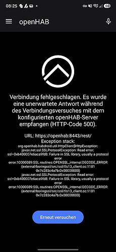

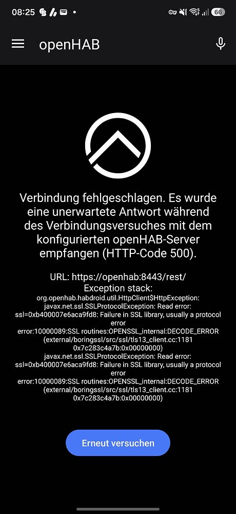

The OH Android App is more detailed, it shows me this:

2. CRYPTO_POLICY=limited breaks TLS 1.3 (breaks the Android app)
With the cert fixed, Chrome was happy — but the openHAB Android app still failed:
javax.net.ssl.SSLProtocolException: Read error: Failure in SSL library, usually a protocol error
error:10000089:SSL routines:OPENSSL_internal:DECODE_ERROR
(external/boringssl/src/ssl/tls13_client.cc:1181)
That’s BoringSSL failing to decode the TLS 1.3 handshake — a protocol fault, not a trust fault. The same symptom is visible in openssl s_client, right at the end of an otherwise successful TLS 1.3 handshake:
error:0A00009F:SSL routines:tls_process_new_session_ticket:length mismatch
The server completes the handshake but then emits a NewSessionTicket that clients cannot decode. OpenSSL shrugs it off (so curl and s_client appear to “work”); BoringSSL — i.e. Android — rejects the connection outright. Forcing TLS 1.2 gives a completely clean handshake with no such error:
