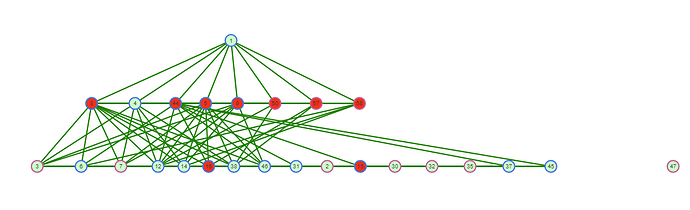

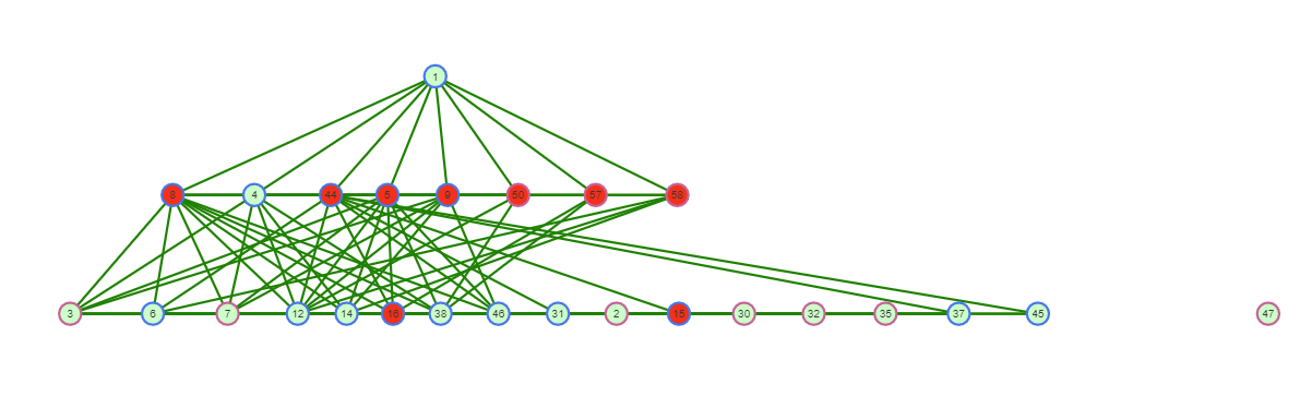

Also you may use the Z-Wave network viewer in Habmin, my nodes are all interconnected.
You may also install a mobile SSH client and your device to tail the logfile the same time you give commands, so you can monitor reaction in realtime. Good luck!
I am using openHAB 2.3.0 Release Build by the way.
Thanks everyone for your thoughts, good idea to check the network viewer.
Where can I find what the different colors mean?
