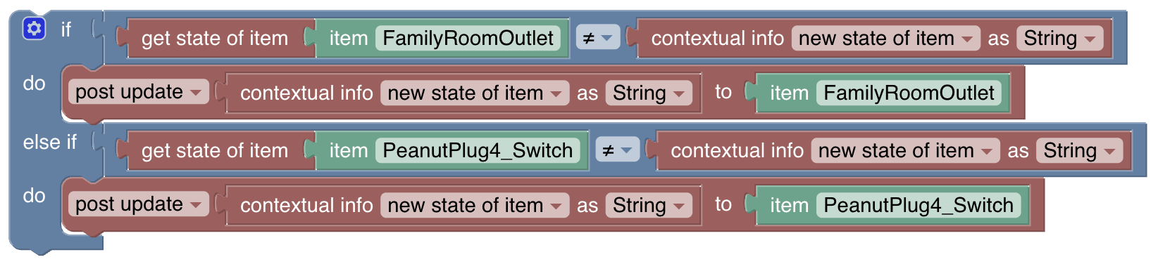

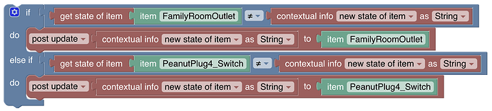

You’d need the following rules to do this with simple UI rules:
  1. When Item1 changed to ON but only if Item2 != ON then update Item2 to ON
  2. When Item1 changed to OFF but only if Item2 != OFF then update Item2 to OFF
  3. When Item2 changed to ON but only if Item1 != ON then update Item1 to ON
  4. When Item2 changed to ON but only if Item1 != OFF then update Item1 to OFF
Its the condition that prevents the loop.
In a single Blockly rule the logic would look something like this:

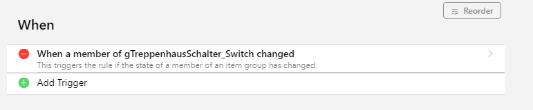

  • trigger the rule on changes to either Item

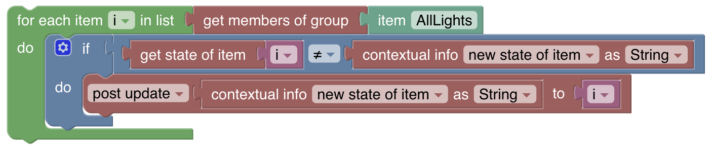

Or if you want to be more generic you can put all the Switches that need to be synchronized into a Group. Trigger the rule using Member of Group changed.
Using postupdate at the end is not sending the ON command to a physical zigbee device which stays in off state at the end (item is linked to a zigbee device). That’s why i decided to use sendCommand. i can do it in javascript but still and always check the state of an item befor sending a ON / OFF command to breake the infinitve loop

i need some help to implement this rate limit into my javascript, not sure how to move this rules from blockly to js
Check the documentation for blockly
var eventItemName, eventItemState, item;
function getOrInstantiate(cache, name, condition, create) {
  condition = (condition === undefined || condition === null) ? ((manager) => false) : condition;
  let manager = cache.get(name);
  if(manager === null || condition(manager)) {
    manager = create();
    cache.put(name, manager);
  return manager;
var OHRT = (() => {
  const ohrt = require('openhab_rules_tools');
  ohrt.helpers.validateLibraries('4.1.0', '2.0.3');
  return ohrt;
function getRateLimit(cache, name) {
  return getOrInstantiate(cache, name, null, () => OHRT.RateLimit());
eventItemName = event.itemName;
console.info(('Event item: ' + String(event.itemName)));
eventItemState = event.itemState.toString();
console.info(('Event state: ' + String(items.getItem(event.itemName).state)));
getRateLimit(cache.private, 'ruleTimer').run(function() {
    var item_list = items.getItem('gTreppenhausSchalter_Switch').members;
  for (var item_index in item_list) {
    item = item_list[item_index];
    if (eventItemName != item.name) {
      console.info(('Item to change: ' + String(item.name)));
      item.sendCommand(eventItemState);
  }, 'PT' + 1 + 'S');
