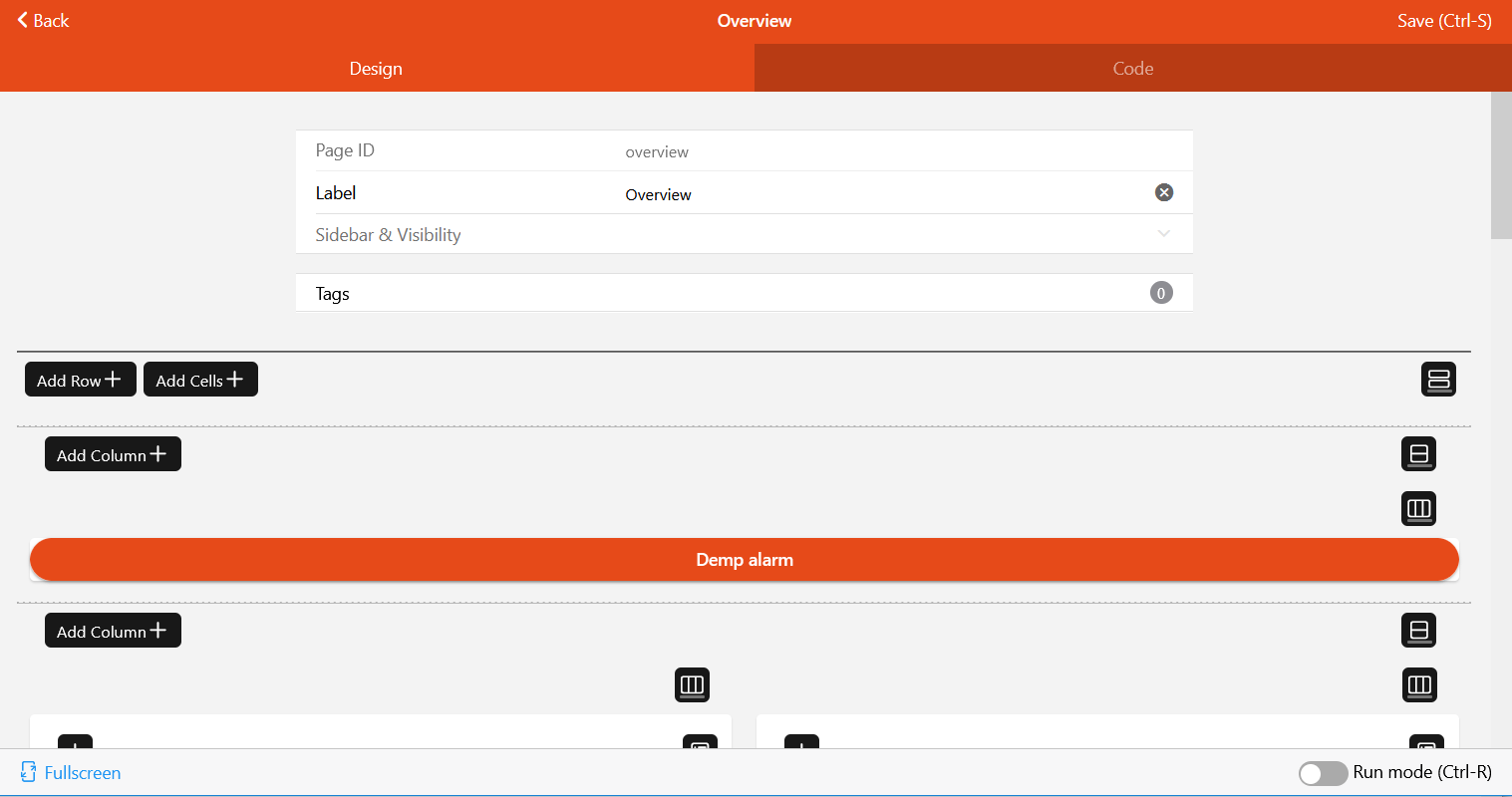

I’m not sure if what you refer to as “UI wizards” is when you “edit” a layout in the UI, or if that is something that is shown during first startup/that I haven’t found. Just to make sure, this is what I’m referring to:
I do switch to the “Code” tab at times, but I don’t do most of the work there - for several reasons (YAML is terrible to work with, I don’t see the results of what I do). Is what you’re saying that using the “Design” tab is only meant for beginners? What happens if you do something in the YAML that is “illegal” in the “Designer” and then switches back to the “Designer” to do something else - will it cope, or are you “forever bound” to using YAML exclusively for that page then?

What I am saying is that once a system reaches a certain level of complexity (and the OH UI is far past that threshold) it is nearly impossible to build a graphical user interface that is suitable for both beginners and advanced users. The Show advanced box in these wizards (or edit dialogs, or config widows, or whatever term you prefer), is a start at an attempt to bridge this gap but it still only gets you so far. At some point an advanced user is going to have to resort to the textual editing because it is just not within the development timeframe or developer team size to create a UI that can handle the vast array of possibilities for even a few of the available components.
I do not recall ever encountering a situation where edits in the code tab have broken the UI editor. The UI editor will display compatible values for its fields or remain blank (if I recall) and it simply ignores fields it has no input for.
