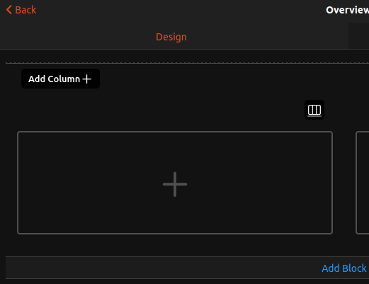

When adding a layout page, after adding block, row and column and then I click on the “+” button, nothing happens ( It should popup the list of available standard widget to let me choose the one I want to add).

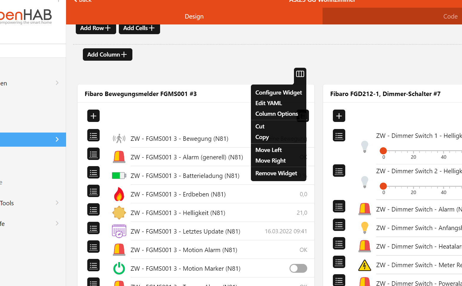

Also with old pages I see the black sandwich menu icon, but when I click on the configure menu nothing happens.

Only hav this problem with the masonry area. Nothing happen if i click on the plus sign

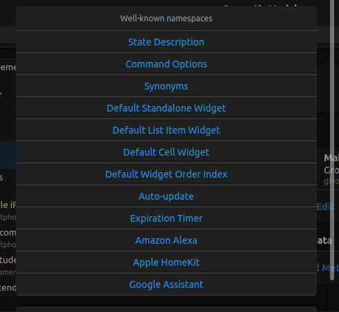

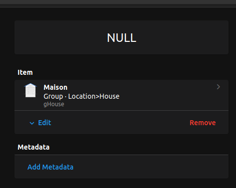

When editing an item :
If I click on “Add Metadata”
then “Default Standalone Widget” for example, the window is completely empty :

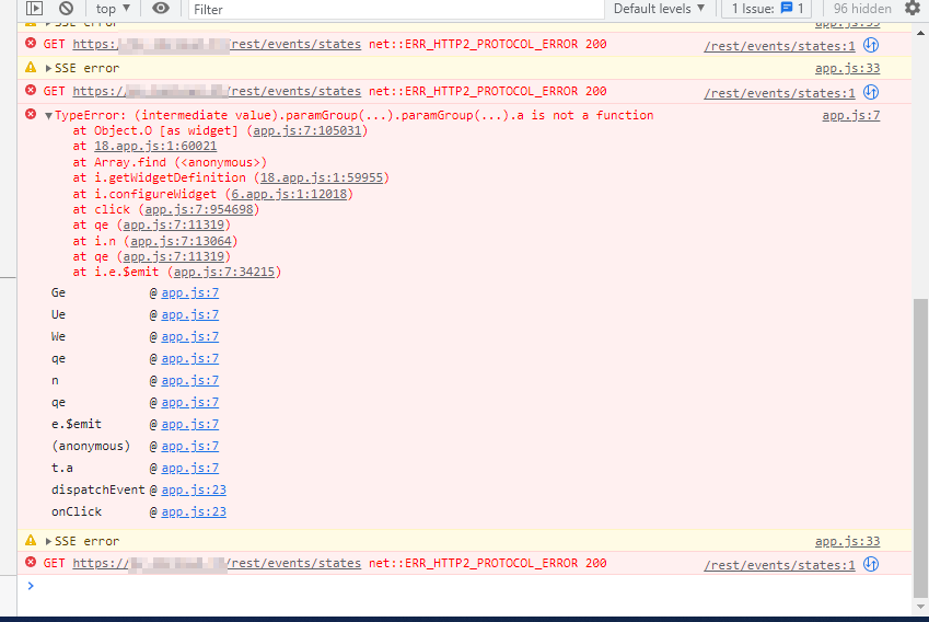

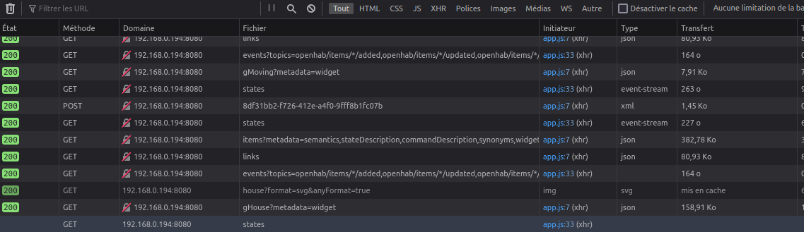

No error in logs, also network debugging does not seem to show any outstanding information :

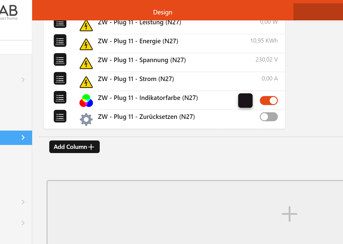

Same here, if I click on the big “+” to add a widget, nothing happens :
