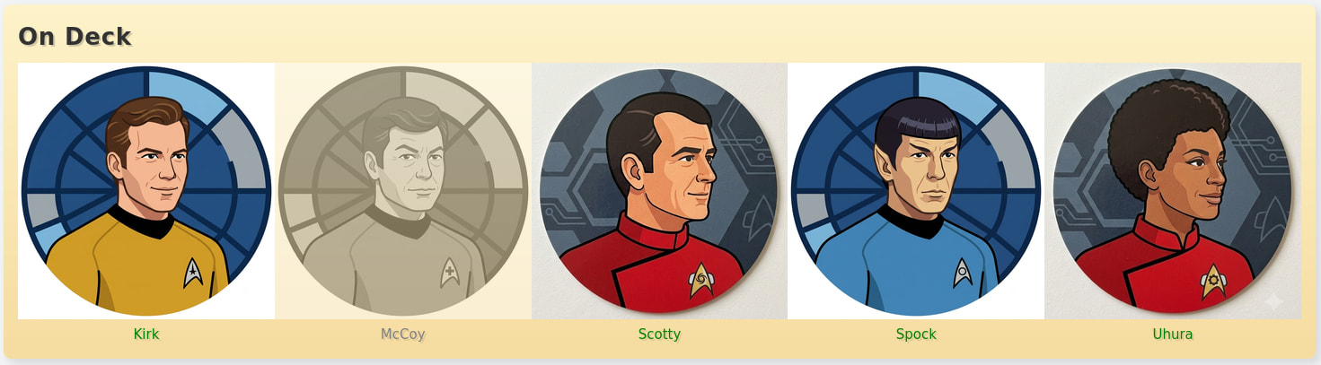

I wanted to share my latest project: mapping my family of five to the classic Star Trek TOS crew for smart home presence detection.
To make it bulletproof, I combined the Network (Ping) Binding with UniFi Client Tracking to counter smartphone deep-sleep dropouts. I also ran into a tricky MainUI limitation: the visual editor doesn’t let you add an OR aggregation function to a group tagged as Equipment. At lest I didn’t got it to do so :wink:
I wrote a quick guide on how I bypassed this via the YAML Code Tab, kept the logic clean from format conflicts (like AP string channels), and tied it all together into the At Home Card widget.
Here’s how the result looks like:
If you are tweaking your Wi-Fi presence or fighting with semantic group aggregation, check out the full write-up with all YAML and DSL blocks on my blog:
Let me know what you think!
Sebastian

thanks a lot for your comment, and suggestions. Obviously a topic I’m not done with and have to study more.
Sebastian
