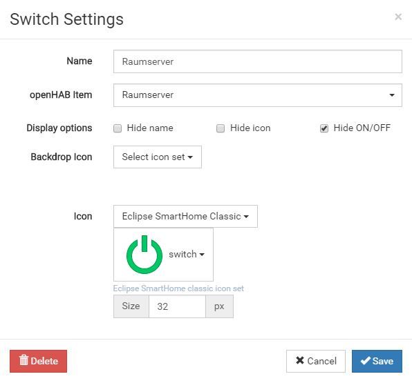

So that switch shows you the current state of the program/daemon and you can start/stop it.
