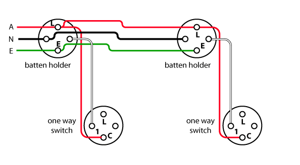

You can get 1 wire like the shelly 2 dimmer however they work best with incandescent bulbs. The put power though the load (globe) all of the time so a cheap led may flicker. Its a limitation if you by the switch type.
If your house it loop at the light you can install them at the light point and use the same switch to control like your pull switches.
You can also retrofit a lamp if you have them.
Do you want to start there?
