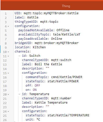

I bought a smart kettle when it was on special (cheap) It is controlled by a ESP8266 and a TUYA MCU. I just changed the software on the ESP to TASMOTA so I can control it however I like. “Hey google turn the kettle on”
Ok do what I tell you PIC
If you want to know if it may work with tasmota look here https://templates.blakadder.com/
Openhab 2 Intergration for Kettle VScode
Openhab 3 MQTT intergration using fancy new main UI

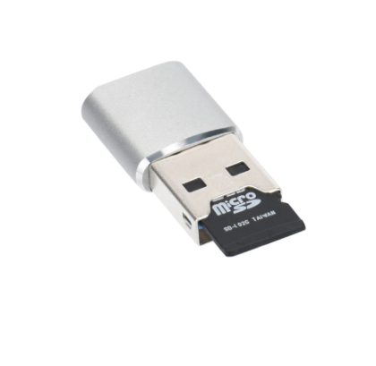

Buy a spare sd card reader and do automated full backups.
I have one of these plugged in so if I need to restore backup I just take the sd card out of reader and put it in PI
