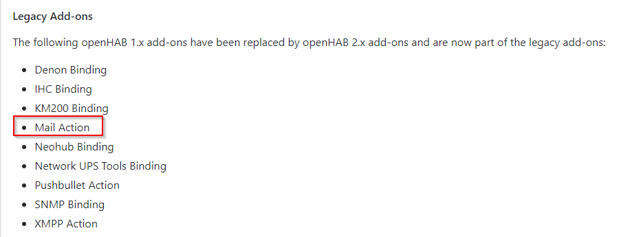

I have restarted my OH system. No change. Nothing ever defined via PaperUI. Just the ‘thing’ config and the rule.
Don’t worry about “funny”. I continue to struggle with each new binding, it seems. I am only using config files unless the PaperUI is mandatory.
OK, so the Mailbinding WAS an issue…now corrected. However, I am not clear regarding the Mail Action V1. Would you be kind enough to elaborate and hopefully provide the rule coding? I learn best by example. Clearly I misunderstood the docs that I read.
The Mail Action is an optional add-on, like bindings are. You don’t want it because you are instead using the Action integrated with the v2 Mail binding. If both are present, there can be conflicts. I don’t have any free code to explain that situation.
