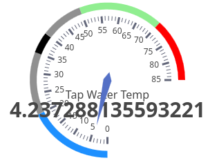

The state description is not going to be shown on the Settings → Items page. The first looks like it might come from there. It’s hard to tell.

You’re right, so the first image doesn’t tell much I guess. However, with the widget I would expect the state description to be used when simply doing itemName.state (that’s my experience from other widgets at least). Here is the entire widget code:

Nope. itemName.state will always show the raw state of the item. If you wish to show the state formatted by the state description, then you need to use itemName.displayState.

That’s what I don’t understand though. It’s a sensor. It’s a temperature sensor. Don’t you want the value of the Item to actually reflect the actual temperature? By using a Dimmer and transforming it, the Item’s state will be around 20% off from the actual temperature.
Yes, I should not have called it a sensor, because it’s actually a servo controller that turns the knob of a thermostat. The servo controller (using tasmota for this) accepts 0-100, and that corresponds to setting the temperature to 0-85.
What would be the preferred method here? Using a gain profile was my first bet, but I never got it to work with the mqtt channel (seems like non-integer values are not sent at all).
What do you want to Item to represent? Assuming it’s a straight forward mapping between the knob position and temperature and you want to use temperature you can use two transformations:

You could also keep the Item state as a “percent” (between 0 and 100) and do the math to convert it to a temperature in the widget.
value =Math.round(85 * (Math.parseFloat(items['Tap_Water_Temp_Control_Tap_Water_Temp_Control'].state) / 100))
Double check the parens there, I might be one off.
Though now that I think of it that probably won’t work because it only converts one way and not the other. Better to use the transformations
