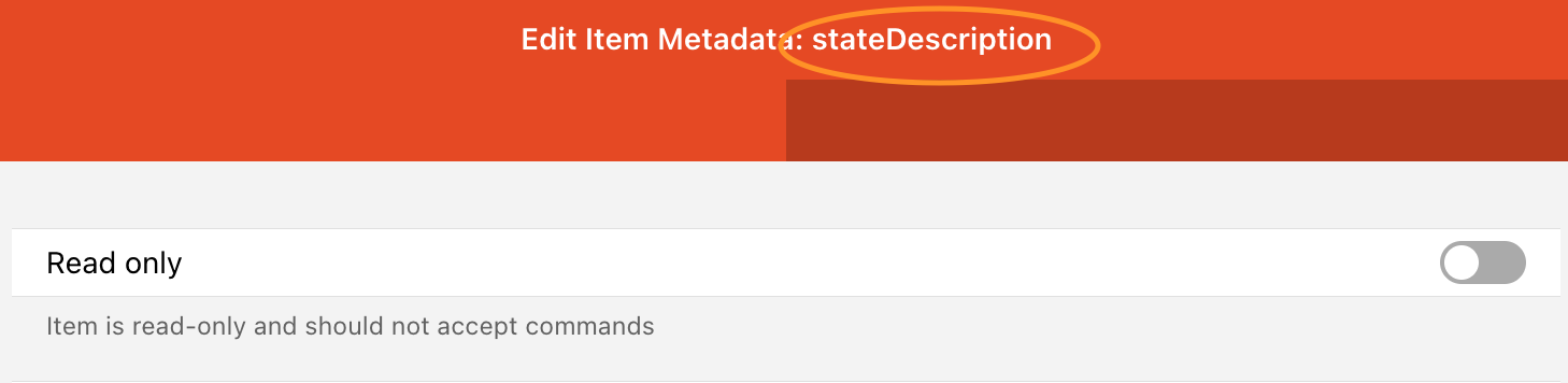

I;m wanting to retrieve the state description metadata in a Blockly rule, I see we have some metadata blocks now, but I;m unclear how I retrieve a state description. What namespace do I need to use? The state description options are in the form of a map, how do I retrieve and use this?
