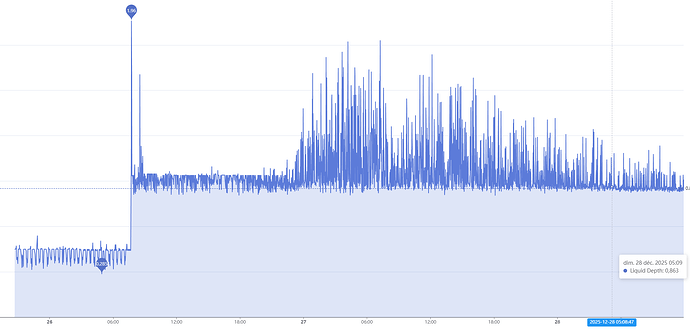

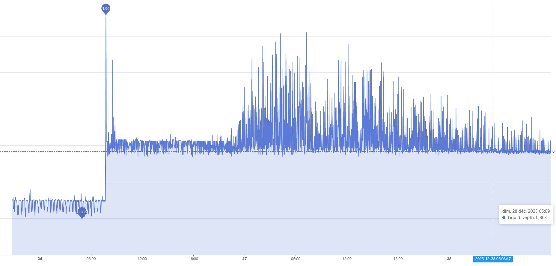

first to give you an overview of the previous situation, this is a snapshot of my previous unfiltered values.
As you can see, there is a lot of noise : value that are completely outside of range.
But as you can also see, the average of values are correct.
The jump on 26 around 8:00 is because we add 500 L to the tank.
What I try so far, is to filter the input value using a condition on DELTA_PERCENT.
This make thing smoother, but I’m not sure if it’s the best solution in my case.
