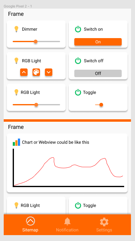

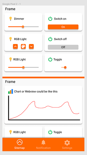

- Legacy sitemaps: arguably the most obvious option, even if they cannot be configured interactively, only via text files; we could also deprecate them in favor of the "new" sitemaps (see below), if there's no backwards compatibility, and rely on Basic UI only to display them;
- "New" sitemaps (i.e. https://github.com/openhab/openhab-core/issues/594#issuecomment-549377670): those depend on @flaviocosta-net and it remains to be seen how well they would cohabitate with the current ones; there's a very interesting suggestion here: https://github.com/eclipse/smarthome/issues/5337#issuecomment-386506325 to version them with the Accept HTTP header, however, I'd like to offer another one: simply consider renaming the concept altogether, to simply "Pages", "Lists" or something of the like, and deprecate the "sitemap" name. If backwards compatibility cannot be ensured, this could be a way to avoid confusion, even if it would require a significant overhaul of the docs,
