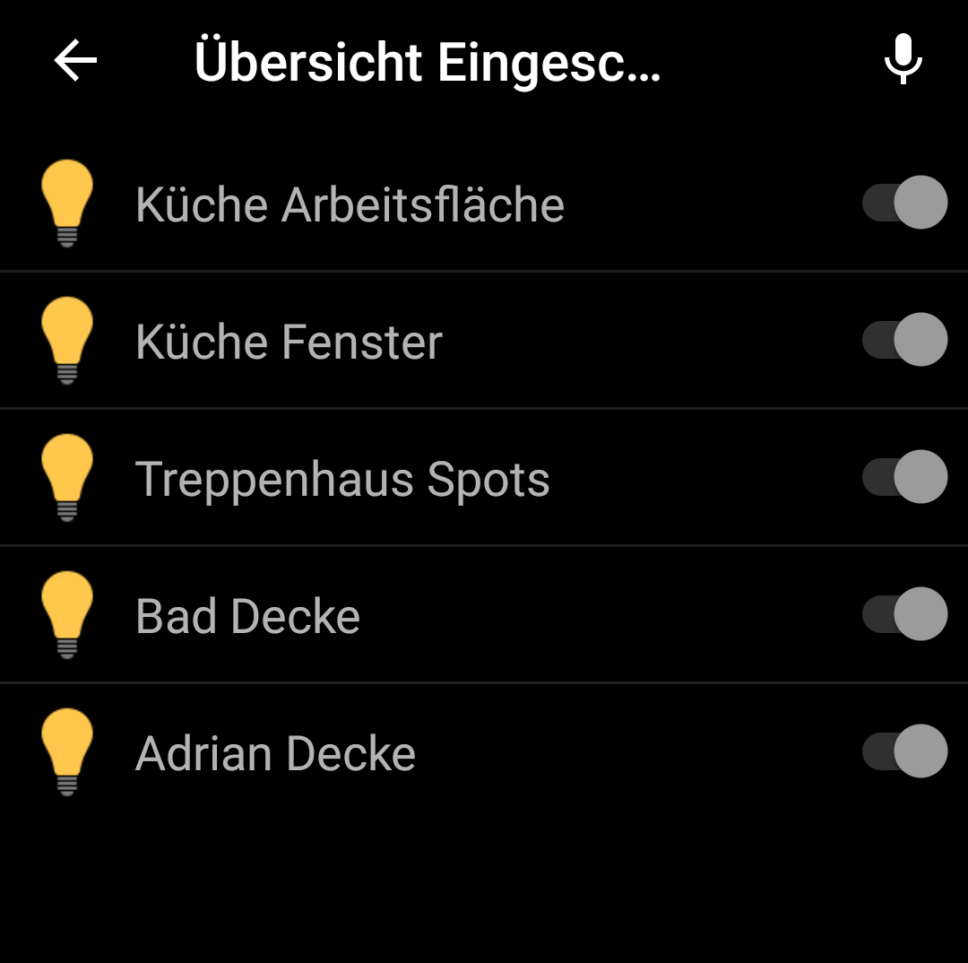

If the state of an item changes sometimes the visibility state in the app gets updated and sometimes not and sometimes there is no update at all… it stays in the last state or doesn’ show up…
Here is an example:
Section showing lights which are turned on:

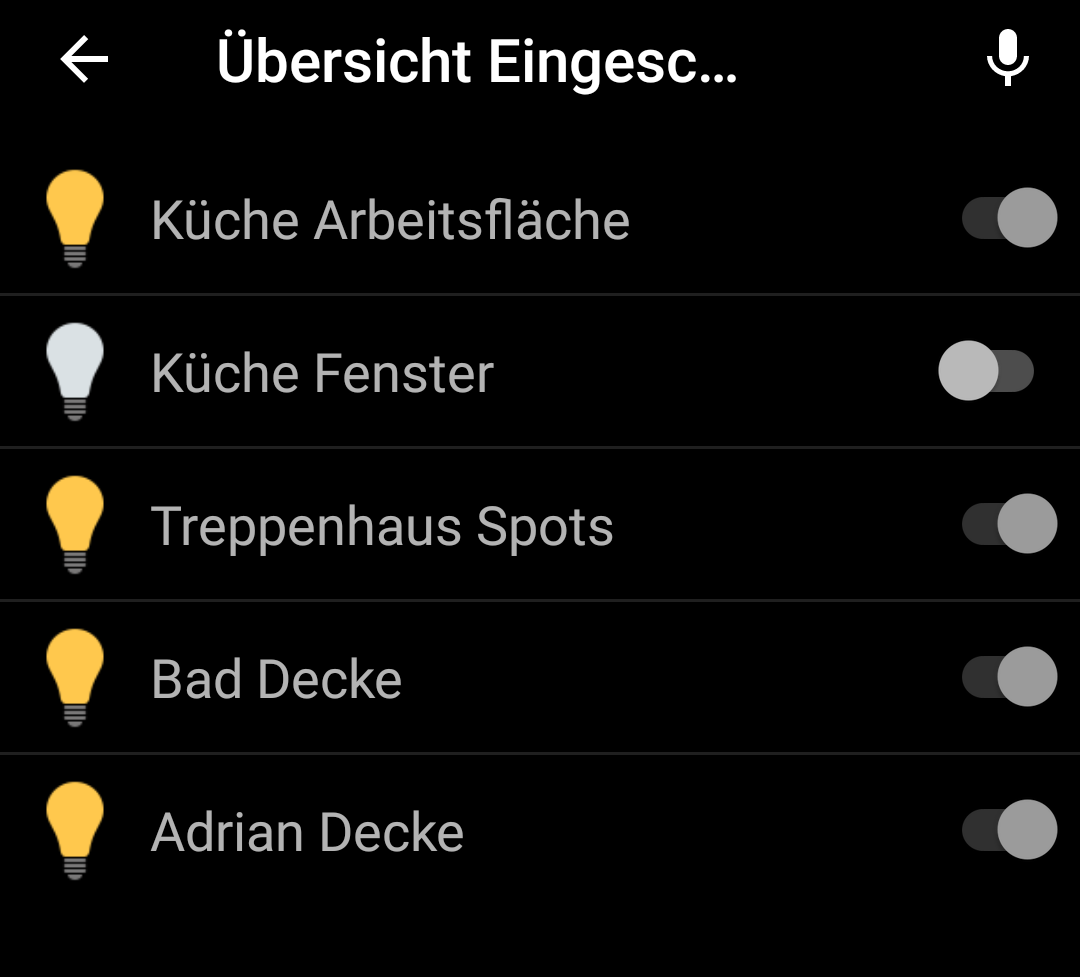

After switching Item “Küche Fenster” off through webinterface:
The app shows that the item was switched off… but the view doesn’t refresh…
sometimes the “show only turned on” view/section doesn’t refresh at all.
