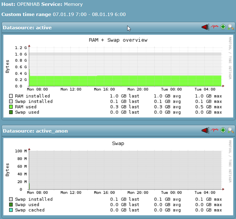

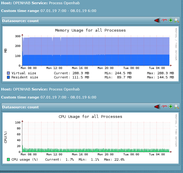

i closed all Openhab Apps on the Android Tablets, rebooted the raspberry and monitored ram usage on the raspberry:
070119 - 07:00 after reboot
all clients/tablets disabled
System Memory: OK - RAM used: 316.39 MB of 976.74 MB, Swap used: 0.00 B of 100.00 MB, Total virtual memory used: 316.39 MB of 1.05 GB (29.4%),
OPENHAB Process: OK - 3 processes 851.9 MB virtual, 313.8 MB physical, 53.4% CPU, youngest running for 85 sec, oldest running for 90 sec

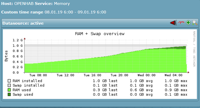

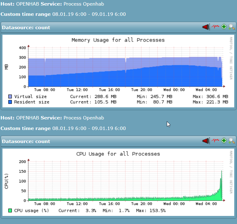

after about 23 hours the ram usage was quite stable which you can also see on this screenshots:
then i opened the openhab app on all three tablets and the system memory usage increased slowly till memory and swap are full:
080119-0648 - starting openhab android apps
System Memory: OK - RAM used: 337.94 MB of 976.74 MB, Swap used: 0.00 B of 100.00 MB, Total virtual memory used: 337.94 MB of 1.05 GB (31.4%),
OPENHAB Process: OK - 3 processes 865.0 MB virtual, 334.9 MB physical, 1.7% CPU, youngest running for 23 hours, oldest running for 23 hours
090119-0549
System Memory: CRIT - RAM used: 902.36 MB of 976.74 MB, Swap used: 99.93 MB of 100.00 MB, Total virtual memory used: 1002.29 MB of 1.05 GB (93.1%, warn/crit at 80.0%/90.0%)
OPENHAB Process: OK - 3 processes 919.3 MB virtual, 588.9 MB physical, 113.8% CPU, youngest running for 46 hours, oldest running for 46 hours

I don’t necessarily see anything fundamentally wrong here (yet).
OH uses a lot of memory and Java never releases any to the public. But any unused mem is paged out after enough inactivity so swap grows, too.
Check the -Xms and -Xmx options Java is started with (/etc/default/openhab2) and eventually reduce them to 250m/350m to see if that makes a difference. Note the latter is the maximum heap size that if reached makes the Java process crash (but that does not apply if it’s something other than the heap to grow).
Other than that as @matt1 proposed try removing bindings and UIs to identify if one of them is the culprit (I recently disabled Hue in my setup as that apparently caused my OH to grow beyond bounds).

I agree there is an issue because…
  1. You see a problem that you describe as a crash.
  2. The Swap should stay empty as it is not a good thing to use slow flash instead of ram unless your system is trying it as a last ditch attempt as the ram is full.
  3. The ram filling up like that is a classic memory leak symptom.

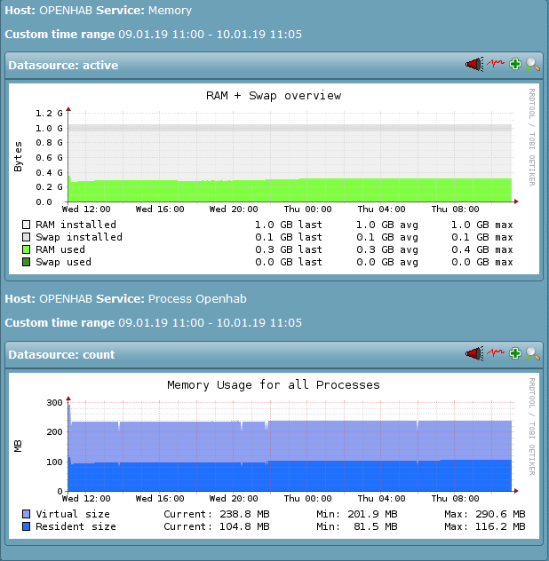

24 hours later… looks like that the hint from @matt1 and @mstormi did the trick…
memory usage since changing heap size and reboot yesterday is currently “stable” …
did no other changes since then… the items visibilty state in the android openhab apps
are more responsive also… at least most of the time…
a slight increase of memory usage is noticable… hopefully this will not result in a very slowly dead…
we will see…
what makes me wonder about this whole issue is… never had problems with heap size and memory before… using openhab since 4 or 5 years now… maybe because we moved into our new house and my environment growed over the last 1 1/2 years?
i will also try setting only Xmx as stated by matt1, reboot the server and will report back in about 24 hours :wink:
thanks for patience and support!

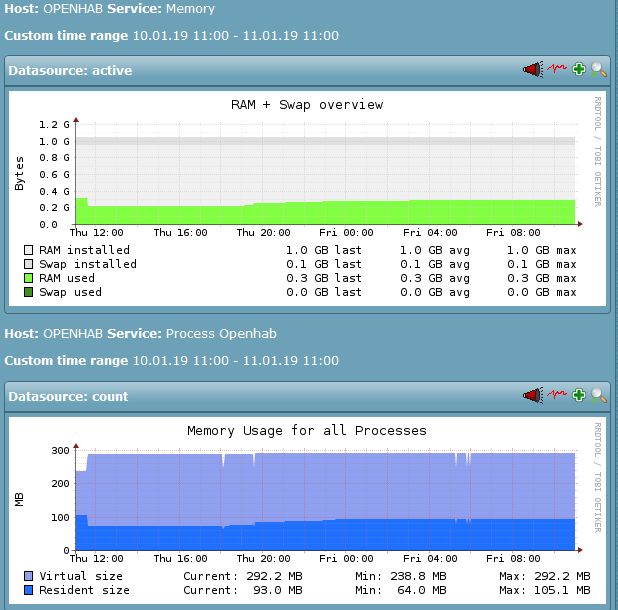

again 24 hours later… back again :wink:
currently the ram usage with Xmx512m setting is “stable”…
will then start to add some more bindings again and also reactivate some rules…
lets see what happens then :wink:
