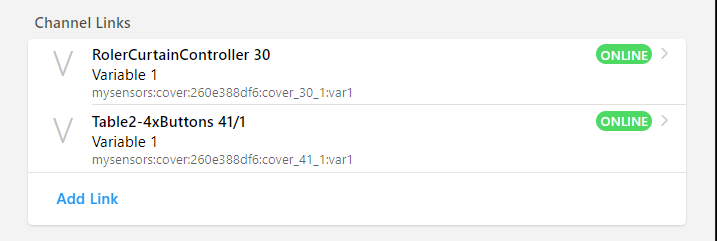

I’m using openHAB3 for a while with mysensor addon. I have created simple item “Blind 1 Cmd” for my window cover and there are two linked channels. One from the controller and second remote button. I need to send command and update status on both these channels but it doesn’t work - both channels are set to DEFAULT profile. Is it correct settings? What is wrong?
I would expect this is base functionality of OpenHAB - to synchronize status of all nodes linked together.
When I try to control window cover by button, status in OpenHAB is updated but not forwarded to the controller. Same when status is changed by controller, new status is not forwarded to the button (to change LED status).
I have lates OpenHAB 3.2 running on Windows and org.openhab.binding.mysensors-3.2.0-SNAPSHOT.jar.
Before I tried MQTT communication with mysensors. There is possibility use parameter postCommand=“true” but it does an echo, it is sending cmd back to origin node.

Alright, what doesn’t happen for you?
When using MySensor binding, the command is not forwarded from one linked channel to second one. For example, when I press the button, the status is updated on the item, but not send to the controller. And when cover reach the target, controller update position on the OpenHAB item and set V_VAR1=STOP, but these information again are not send to the button.
Yes, that is normal and by design. Messages coming into openHAB are usually treated as status reports, not do-something instructions. By design, a state update is not normally forwarded to any other linked channels for action.
